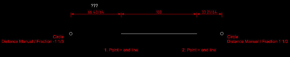

riverbuoy wrote:You can also enter a negative value. This will return a point before the first
point. (Note: You can enter fractions as '1/7', or '3/11' for example.)
Hi riverbuoy - really nice and useful tool - thanks for doing this!
May I ask you something what I haven't understood yet:
If I use a positive value like 1 1/3 Fraction I get a result what I have expected.
If I use the same value as a negative, - 1 1/3 or - (1/3), I don't understand the result. Could you please explain how it works correctly.

The command uses RMath.eval function to evaluate expressions. In expressions we
often leave out plus signs. So if we include the plus signs, for positive numbers
it evaluates as +1+1/3 which equals one and one third, as expected. However for
negative numbers what you have is -1+1/3 which equals minus two thirds. So to get
what you expect you need to negate both parts, i.e. -1-1/3, or negate the whole
number, i.e. -(1 1/3).
Hope this explains what is happening.
