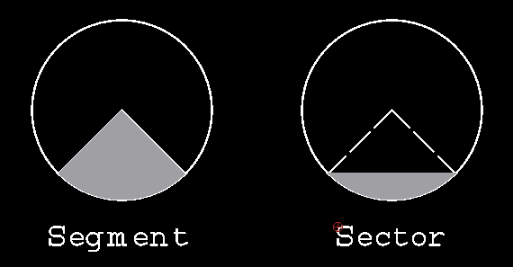

For arcs, there are two options for calculating areas, namely Segment or Sector. The area of a segment (or slice) is the area bound by the arc and and two lines drawn from the arc's startpoint and endpoint to the arc's centre. The area of a sector is the area bound by the arc and a chord drawn from the arc's startpoint to the endpoint.

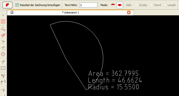

Language: I tested your tool also on a German QCAD Interface. The language in the toolbar is mixed and the text in the drawing is always in English. It would be nice if your tool could also adopt the Language settings in QCAD ...

In sector mode, the Chord button determines whether a chord entity is added to the drawing. In segment mode it determines whether the two segment lines are added to the drawing.
The length button determines whether extra info is added to the drawing. The reason it prints both the arc length and chord length is, when used with polygon area, you need both these values to calculate the circumference. You subtract the chord length and add the arc length to get the circumference.
