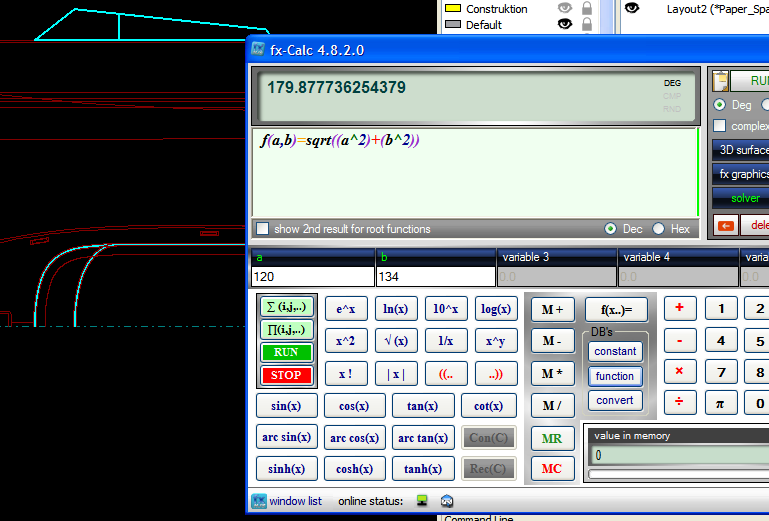

Hi Clive,Clive wrote:Personally I still think a dedicated dialog would be better
I work with fx-Calc on Windows - the nice thing about this stand alone calculator is that it has a customizable "Function Database" and it works with up to five Variables.
And .... oh yes ... it is free ....
I start this calculator program with a keyboard shortcut (Alt Gr + c) and I'm able to keep it on top (Alt Gr + t) displayed over all other running Programs like QCAD. Yes, you are still not able to dock it to QCAD but you can place it at a convenient position and it is always visible. Hey .... that is very close to docking ... isn't it.
Shortcut and "always on top" can be controlled on different ways - I use "AutoHotkey" because in the case of a move to an other Computer I have everything what I need just in one file .... lazy me
