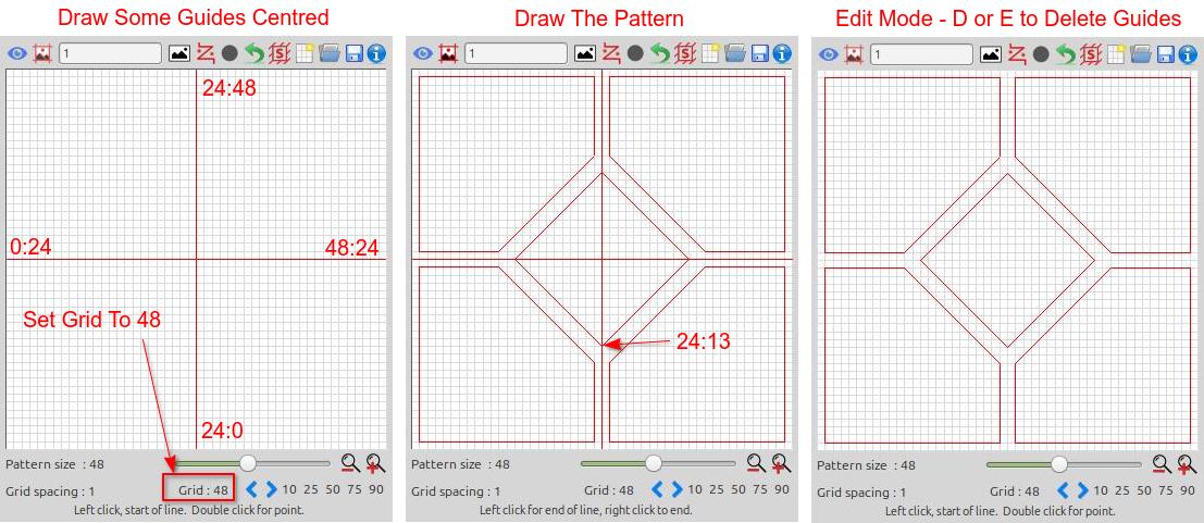

Hi All
Here’s another example of how you could use the blue markers to help you draw a pattern.
In this example I’m using “bpm-herringbone3-1.bpmlc” which you can find in the downloaded zip file folder called BPM-Sketches.
This pattern has been drawn on a 6x6 grid, to enable us to place gaps between the boards we’ll use a 36x36 grid “which is dividable by 6”, mark positions with the “Blue Markers” and redraw the original which will give us a our guides, these are later removed by using the "Edit Mode" feature in the App.. The gif below shows the steps.
This link explains how to create ratio herringbone patterns with BPM.
https://qcad.org/rsforum/viewtopic.php? ... 995#p42150
Happy Hatching :)

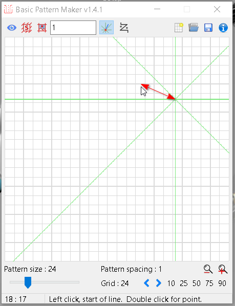

Hi All
FYI BPM uses it's own built in magnifier using the mouse scroll wheel or + & - keys, if you have a screen magnifier set this may cause guide & mouse pointer misalignment as shown below..
Please Note:-This only applies to people using "Ease of Access settings" with their display magnification set higher than 100% and the crosshairs/guides are not directly under the mouse cursor.
These settings are for Windows 10, Windows 7 will be slightly different but similar regarding DPI.
If this needs corrected do this:-
Apply these settings to your desktop shortcut or the exe file.
64bit location C:\Program Files (x86)\Basic Pattern Maker\BPM.exe
32bit location C:\Program Files \Basic Pattern Maker\BPM.exe
I hope this helps anyone that might have had these minor problems....

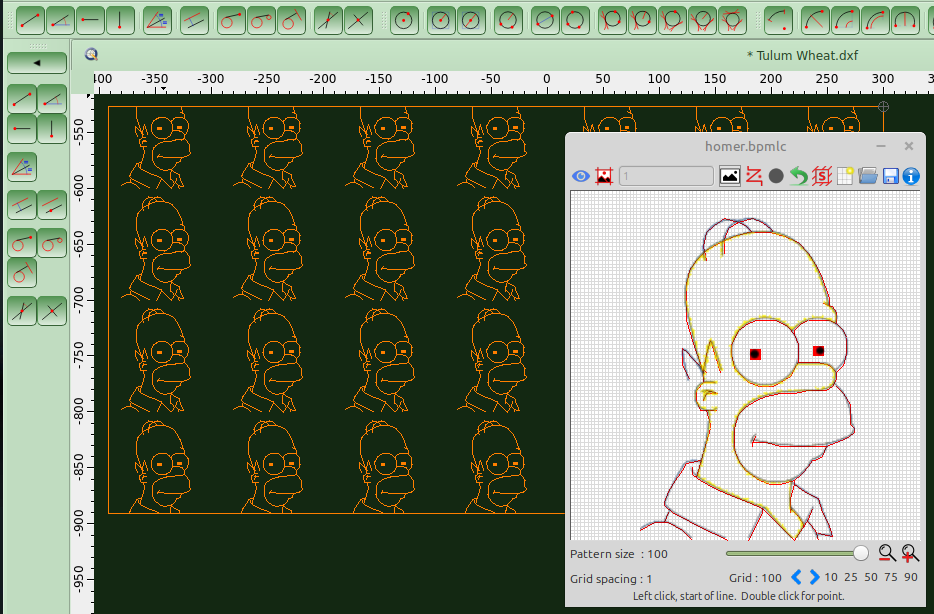

:lol: :D
Homer hatch ten million from origin
