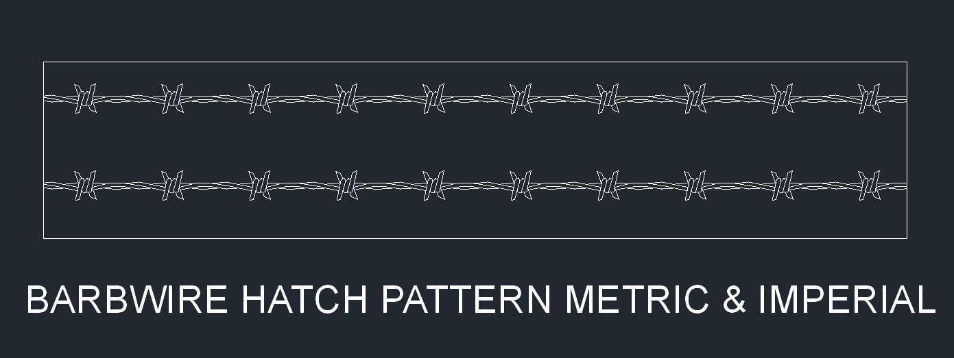

Re: Free Hatch Patterns
BARBWIRE Hatch Pattern, Handy for Architechs Adding Wire to Fences
- BARBWIRE - Metric and Imperial.zip
- (2.5 KiB) Downloaded 1632 times
- barbwire.jpg (61.31 KiB) Viewed 35228 times

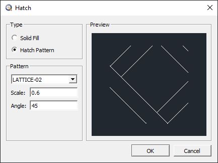

Hi Andrew
I noticed in Qcad 3.24 that small lines are rendered as points, this is good but I had to redo LATTICE-02.PAT
manually as it had a Zero on the end of 2 lines, I've commented in PAT files where... if the current Pattern
File is Exploded it shows these points and sometimes even if not exploded also shows them slightly.... anyway
here are the updated Files please just write over the older ones..see what I mean by points in image below..
- Fixed Lattice-02 Pattern.jpg (16.69 KiB) Viewed 35186 times
- Lattice-02 - Points.jpg (19.59 KiB) Viewed 35187 times
- LATTICE-02 - Imperial and Metric Updated.zip
- (595 Bytes) Downloaded 1660 times

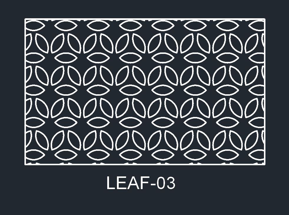

LEAF-03 PATTERN
Using Tool Developed by CVH "Tile2Hatch tool © CVH 2020"
Pattern Will be updated ASAP
New Updated Pattern now on Page 4 of this topic
- LEAF-03.jpg (132.66 KiB) Viewed 34997 times

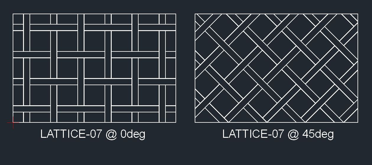

LATTICE-07 Pattern [ Similar to LATTICE-02, but woven instead of overlapped ]
You Can Also Create This With My Free Basic Hatch Tool, That Can Be Downloaded Using The Link Below..
https://www.qcad.org/rsforum/viewtopic. ... =15#p33566
- LATTICE-07.jpg (85.78 KiB) Viewed 34963 times
- LATTICE-07 - Metric and Imperial.zip
- (666 Bytes) Downloaded 1630 times
