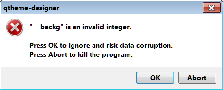

Alright, so I've been trying some colors with Qcad theme designer. I don't know what happened but I arrived at a point where every time I try to save my theme I get this error:
" backg" is an invalid integer.
Press OK to ignore and risk data corruption.
Press Abort to kill the program
I was able to save it normally, I don't know what happened. I'm attaching the stylesheet file

The only thing I can see that has a possibility of creating the error is to do with Tab Bars - Hovered gradient top in the Misc tab, and even then I'm struggling to see how it could happen. Is it possible that you'd just changed the colour for Hovered gradient top prior to the error occurring ?bob93 wrote: ↑Fri Mar 01, 2024 8:29 amEDIT: The last thing I did before it stopped saving was to make almost all pairs of button top/bottom gradient colors equal (because I wanted to create a theme that's mostly flat/solid fill except for some things) and then set Push and Toolbar buttons to solid fill
There's certainly nothing wrong with the stylesheet you attached.

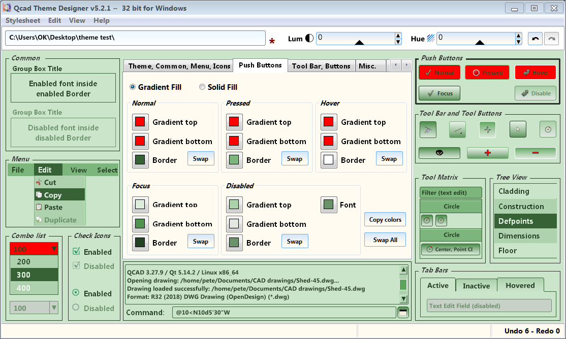

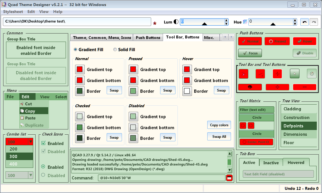

Here's how I was able to reproduce the problem on Windows, Qcad Theme Designer v5.2.1:
Load default style
Save it in a folder on the desktop
Go to Push Buttons tab and set all Gradient tops and Gradient bottoms to the same color (for example red, see attached image 1)
Go to Toolbar Buttons tab and do the same (see attached image 2)
Save the theme. It saves normally
Go back Push buttons tab and select Solid Fill
Go to Toolbar Buttons tab and select Solid Fill as well
Save theme. Error appears.
Nothing to do with the Misc. tab apparently.
Only way to save theme after error appears is to select Gradient Fill instead of Solid Fill

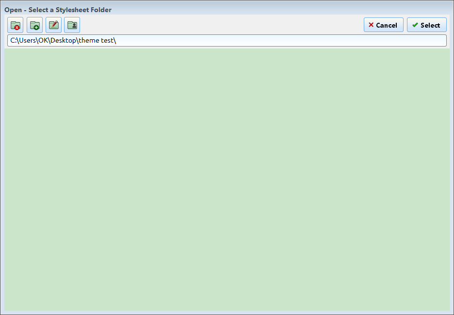

I'm not sure what you mean by actual colors though. The first time I saw the error (when I sent the stylesheet file) I was using greys instead of red. Both greys from the palette and custom greys I had defined. Hopefully your fix takes care of all of this. Fingers crossed

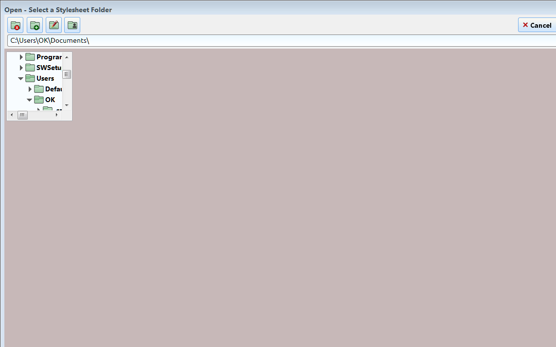

Now, while I was dealing with this I seem to have come across another issue.
I only captured part of the window which was huge. If I resize this window to a smaller size then it looks like this (folders don't show):

Re: Qcad Theme Apps
I've pretty much redesigned the browser and the way all the components are positioned, so that should cure what I'm seeing there. I've never come across that !! Here's a pre upload taster......bob93 wrote: ↑Sat Mar 02, 2024 1:35 pm

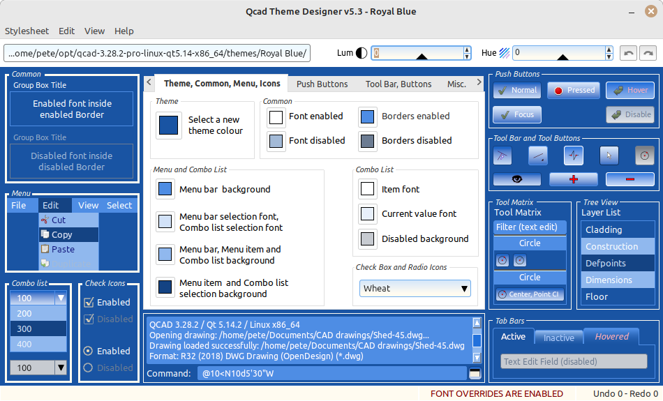

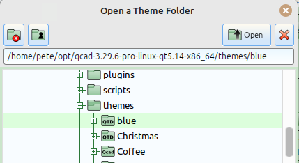

Qcad Theme Designer update, version 5.3
Version 5.3 is a major update, it introduces a lot of new additions, changes and bug fixes.
Qcad Theme Designer is now fully portable, everything is now contained in one folder. To that end you will notice that there are now only two attachments to choose from. The two zipped files are for Linux and Windows. Download the relevant zip file for your OS and extract the folder to any writable location. In the root of the Linux folder is an x86_64 and an i386 executable, open the one that suits your CPU architecture, the Windows folder has only one executable. You can create a launcher/shortcut from within QTD using the new 'Edit>Create a desktop launcher/shortcut' menu item.
The Windows executable is digitally signed and has been verified as safe by Microsoft (view the attached Microsoft verification.pdf file). However, in Windows 7 you may still get a security warning - "The publisher could not be verified". To disable this, right click on the executable, select Properties, and at the bottom of the General tab in the security section, click the Unblock button.

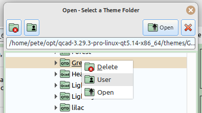

- A 'New' menu item has been added to the Theme menu.
- A 'Preferences' top level menu item has been added, this is populated with the following menu items
- Create a desktop launcher/shortcut (OS dependant)
- Show/Hide Browser node lines (saved to the config file)
- Browser expand sign +/- (saved to the config file)
- Browser expand sign arrow (saved to the config file)
The following displays node lines and the +/- expand sign.....
