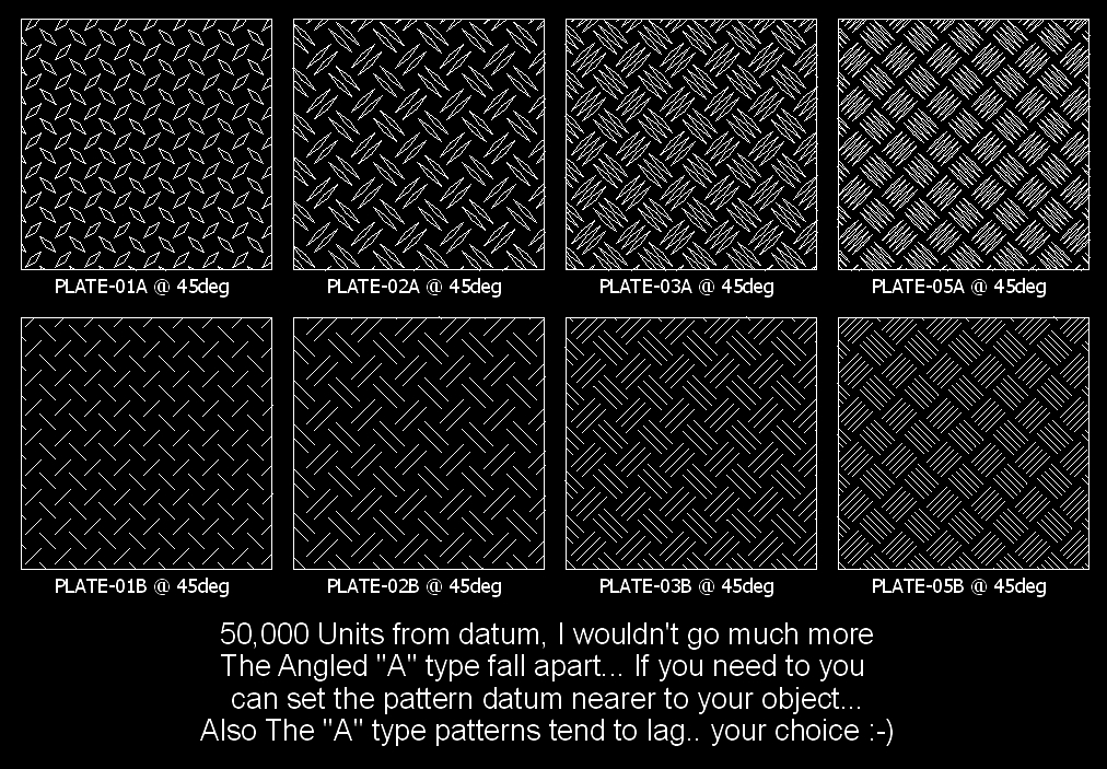

Post by John Hyslop » Wed Sep 02, 2020 10:14 am
Hi All
The Plate hatches with the angles type A
are an absolute overkill and I would highly recommend you use the type B patterns for representation purposes..
Unfortunately all I have ATM is a lisp tool that is not perfect and can cause repeats and clones in larger spans so you've been warned ;-)
Best regards

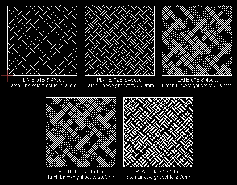

Here are a set of Basic Tread Plate Patterns...
Note the Lineweight is set to 2.00mm [ Metric ] to give it a better representation...
Also Manually Fixed Errors from Lisp Tool on a couple...
1 bar "Propeller Plate "
2 bars " Tread Plate "
3 bars " Tread Plate "
4 Bars " Tear Plate "
5 bars " Tread Plate "
Basic Plate Hatch Patterns.jpg (348.68 KiB) Viewed 52702 times
Plate Hatch Patterns - Metric and Imperial.zip
(3.25 KiB) Downloaded 1748 times

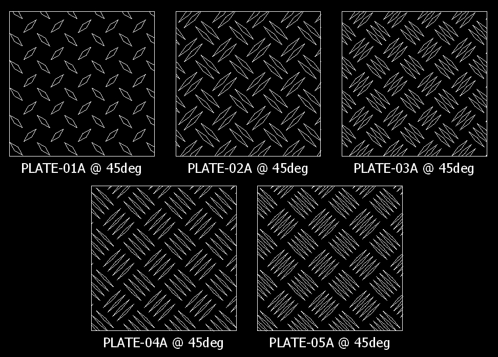

Post by John Hyslop » Sat Sep 05, 2020 12:28 pm
Hi All
I've now fixed up the Type A Plates [ Angled Ones ]
Thanks CVH for pointing out the errors & How to Fix Them ;)
PS
The Metric version of PLATE-05A was displaying 4 bars instead of 5 Please download the corrected version here:
https://qcad.org/rsforum/viewtopic.php? ... 288#p48288
or download here
PLATE-05A - Metric - Corrected.zip
(937 Bytes) Downloaded 248 times
PLATES - TYPE - A.jpg (342.53 KiB) Viewed 52666 times
PLATES - TYPE - A - Metric and Imperial.zip
(5.72 KiB) Downloaded 1661 times

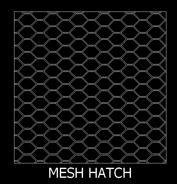

Here is a set of 2 hatch Patterns, MESH-02A & MESH-02B
It''s supposed to resemble expanded mesh...
If you find the hatches scattering at distances simply
set the hatch Origin to the object your hatching Origin
Enjoy
PS Thanks Husky for the suggested pattern :)
Mesh Patterns Metric and Imperial.zip
(7.22 KiB) Downloaded 1618 times

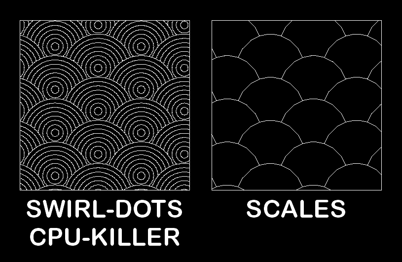

Hi All
Well I have 2 Hatch Patterns Here, 1 I would use wisely , it's a bit of a CPU-KILLER ;)
It was a request so I thought I would share with all, it might have it's uses for small
hatch areas where you want to show a swirl pattern like the swirl steel effect...
Anyway here they are.. Enjoy... :lol:
SWIRL-DOTS and SCALES - Metric and Imperial.zip
(30.74 KiB) Downloaded 1447 times
SWIRL-DOTS - SCALES.png (25.46 KiB) Viewed 52599 times
Posts: 4999
Re: Free Hatch Patterns
Post by CVH » Mon Sep 14, 2020 8:20 am
Swirl-Dots is surely a CPU killer ... :lol:
One can consider the hatch to be an intersection of the area within the boundary and 2185 planes filled with 1 dots per tile.
In Scales we see the magic of angle restriction ... Cloning load is 6 or less. :wink:
Nice.
Thanks John,

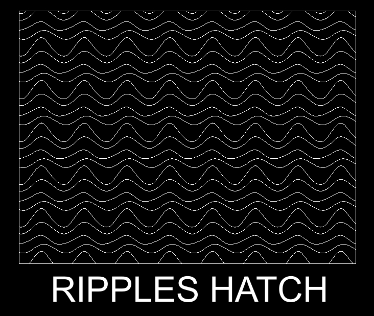

Hi All
2 New Patterns Now Using Tile2Hatch Beta v0.14 © CVH 2020
These are experimental, RIPPLES was created with splines and converted
to a hatch with the above tool.. "I'll be using this for all future hatch patterns"
As Always I'm open to any suggestions Re: hatch patterns..
PS Small update on Cardiograph Hatch , made 2 lines that were on same plane 1 line
It just means it's optimised a bit better, it was downloaded 5 times, no panic :-)
CARDIOGRAPH Hatch Pattern - Metric and Imperial.zip
(2.99 KiB) Downloaded 1327 times
RIPPLES Hatch Pattern - Metric and Imperial.zip
(7.72 KiB) Downloaded 1455 times
RIPPLES HATCH PATTERN.jpg (207.5 KiB) Viewed 51598 times
CARDIOGRAPH HATCH PATTERN.jpg (148.9 KiB) Viewed 51598 times

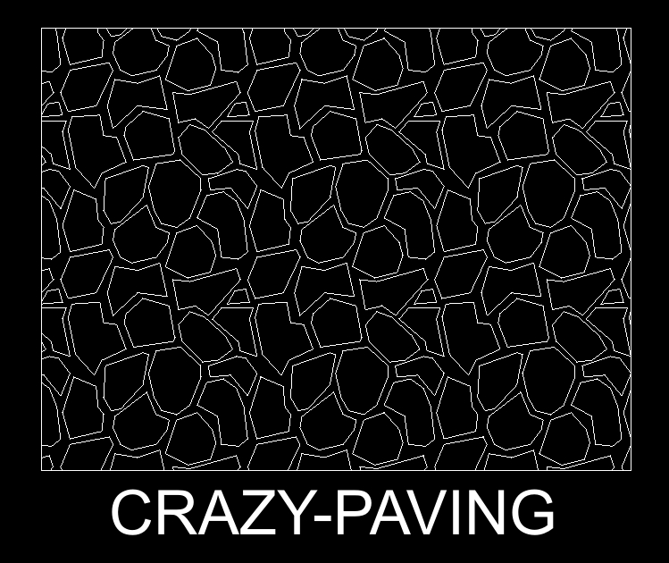

Now some CRAZY-PAVING :D
Sorry to those 5 who downloaded, the pattern had a couple of drifting lines , purely
poor design , my fault.. :oops:
The screenshot is hatched in metric @ Hatch Origins X100,000 Y100,000..it is now fixed .
Updated zip file at the bottom of this post..
