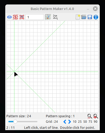

If anyone is interested I have a free standalone Basic Hatch Pattern Tool you can download on link below:
It works on Linux ( WINE ) & Windows 2000 - Windows 10 32 & 64bit ,
It can be used to create hatches for QCAD Community & Pro Versions.
Also try Basic Pattern Maker created by Myself and PeteVick, create your own basic hatch patterns.
Basic Hatch Pattern or Basic Pattern Maker which is Windows and Linux Compatible
https://qcad.org/rsforum/viewtopic.php? ... =45#p39904 <--- Basic Hatch Tool
https://qcad.org/rsforum/viewtopic.php? ... 995#p42607 <--- Basic Pattern Maker

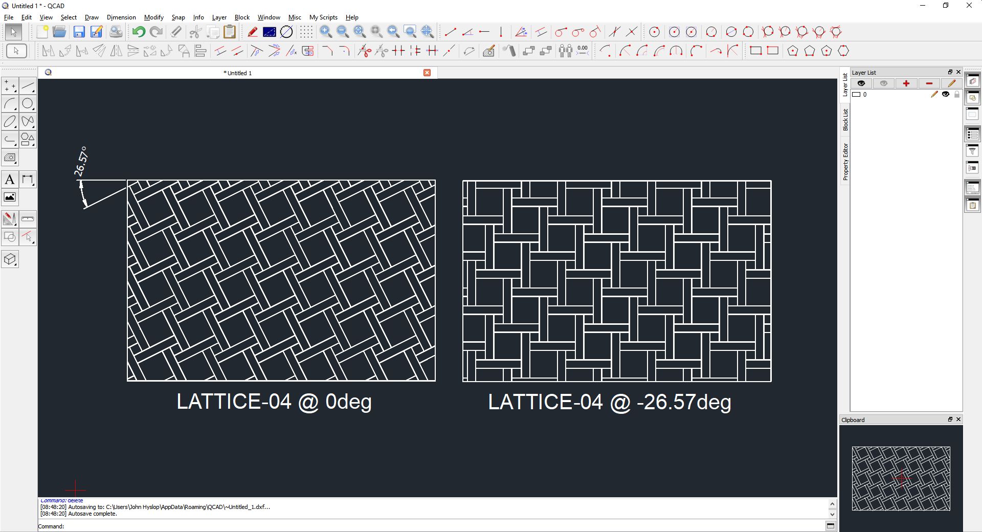

LATTICE-04 [ see angle note on screenshot ] to make it orthogonal..
If you require a more accurate angle the true one is 26.565051deg :-)

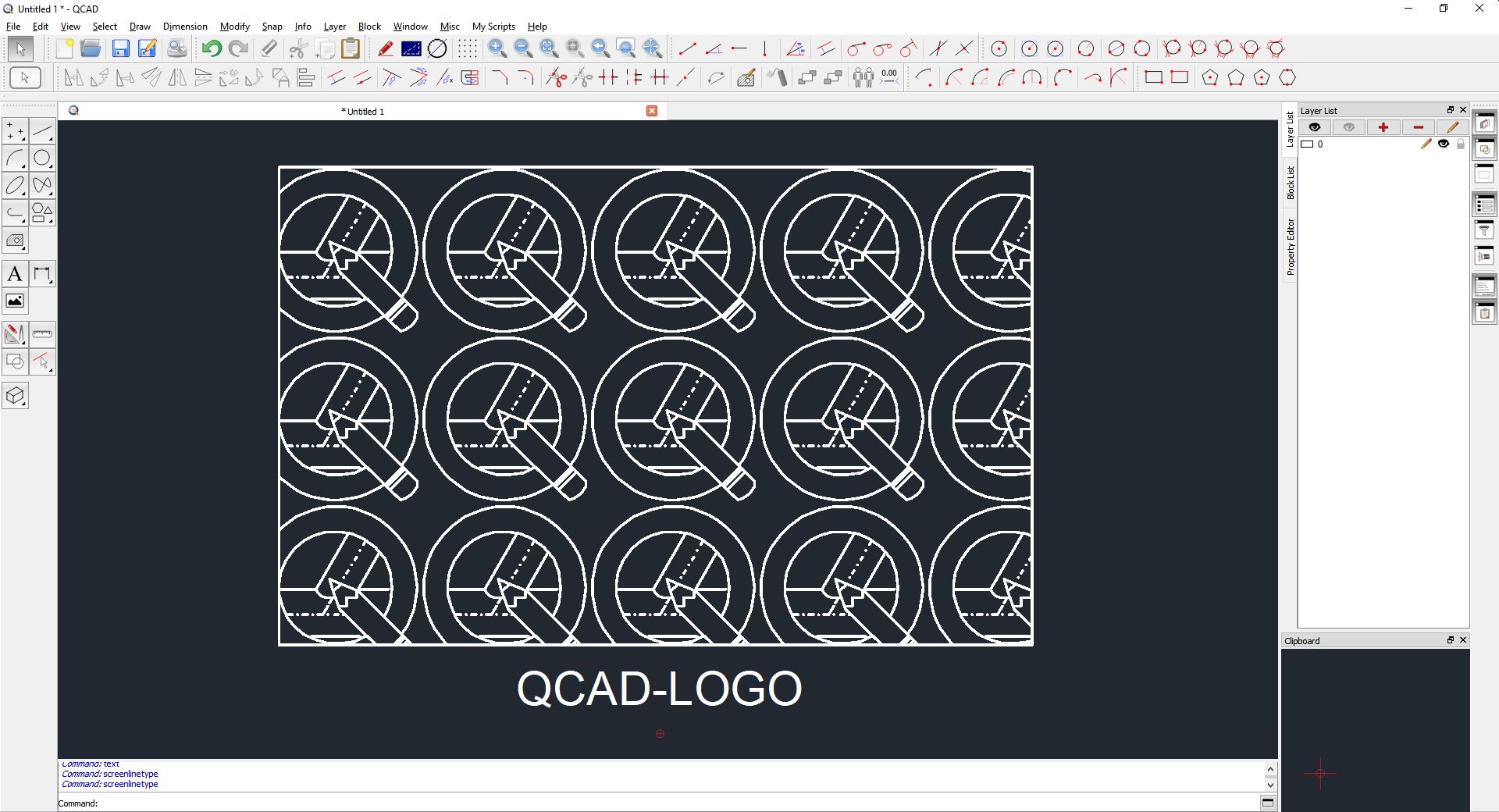

QCAD_LOGO
This one is a bit rough as you cannot use arcs or circles in *.pat files
only points and lines...
New Updated Pattern now on Page 4 of this topic
QCAD-LOGO.pat
(6.71 KiB) Downloaded 2061 times

John,
Are you doing these by hand or do you use the Autralian tool?
QCAD-LOGO consists of 125 lines... :shock:
But thats nothing compared to YUKONRUBBLE.PAT, 4533 lines. e_surprised
Although, Qcad can't handle that one.
Simply google 'YUKONRUBBLE' or 'yukon rubble hatch pattern'.

Can you elaborated why LATTICE-04 is defined slanted at 26.57 degrees?
(The definition is with 26.565051 degrees)
Posts: 524
Re: Free Hatch Patterns
Post by John Hyslop » Fri Nov 22, 2019 3:50 am
Hi CVH
The angle was just an approximation to visually set it orthogonally...and I didn't want to confuse people with too many numbers after decimal place :-)
Andrew is quite happy with me doing these free hatches and is including them in the next release of Qcad Pro and free versions..
I do all the designs by hand and use some tools to convert to lines that need some mods afterwards..
I will update the angle on my post, but really if people are going to explode this and use as entities
they will work out the angle needs to be tweaked a bit :-) Thanks for pointing this out though..
Bye the way I did see the post you refer to, but nobody has followed up and offered free designs that are out of the ordinary compared to the ones you can download, I'm also offering custom ones if people have ideas but obviously when time prevails, I would need to put my business 1st ...
Also elaborating on why I did this this way "at this obscure angle" , have a go at making a seamless version of it orthogonal :-) it's impossible...
FYI I'm attaching a screenshot of how I made this pattern the yellow lines I put there to indicate how the pattern becomes seamless as it is
arrayed horizontally and vertically :shock:
Make Seamless Pattern.jpg (12.91 KiB) Viewed 66479 times
Noop, revision included. 8)
Never say to quick something is impossible with computers. :wink:
BTW: added credits and remarks.
Maybe you could include something similar in new ones and revisions.
If you ask Andrew, I think he would be glad to include that too.
From the screenshot is clear we have different approaches.
Your method is more like the old tiles but coded as common patterns.
And now I understand the funny decimal numbers for a pattern with only lines...
Every line segment we see consist in fact of 2 colinear parts.
Many or complex or very fine hatches tend to slow Qcad.
The number of rendered entities counts here.
So there is room for improvement. :wink:
Hopefully the dxf explains enough what I did.
The revision halves the rendering effort.
Qcad has two sets pattern files. Some files are exact clones, some are scaled.
When drawing in Imperial units we only see the Imperial list, with metric only the metric list.
I think its a good idea to create metric counterparts of yours.
For one, because the preview in metric is almost a solid fill. :|
What I do a lot:
As CSV to a spreadsheet, apply corrections, concat to text lines, copy, paste.
And if we didn't say it enough:
Nice work,
blown by the effort needed.
LATTICE-04b.pat
(623 Bytes) Downloaded 1940 times
LATTICE-4-rev.dxf
(127.51 KiB) Downloaded 2153 times

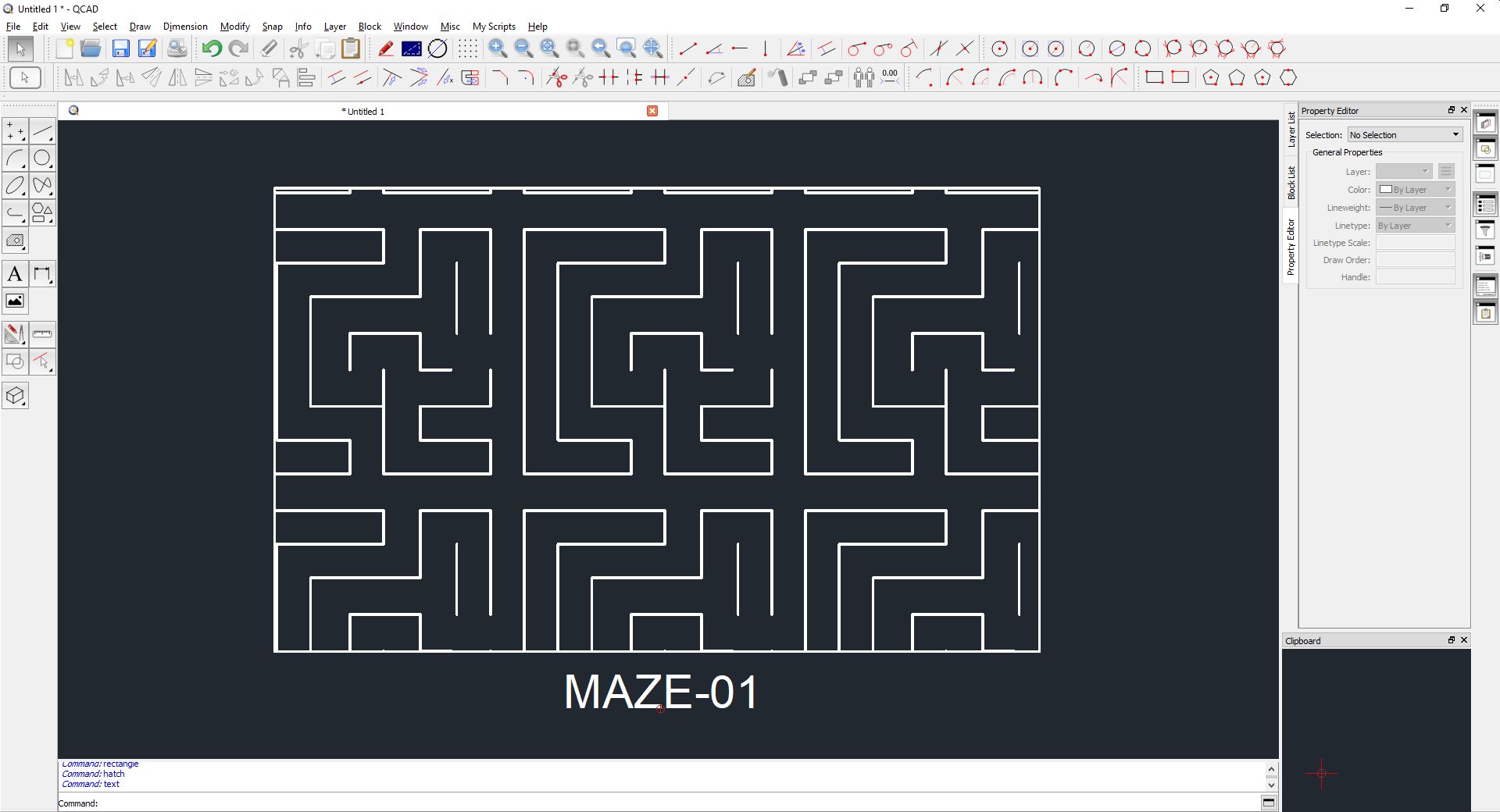

[ MAZE-01 ] Qcad Hatch Pattern
