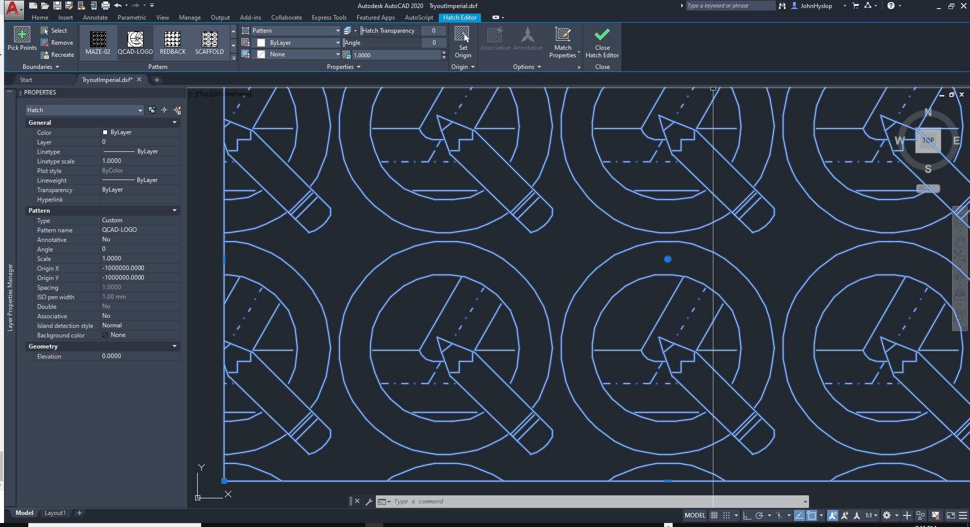

Included is a dxf with the Qcad Logo by John. Don't ask me what revision, it doesn't care.
TryoutImperial.dxf
(231.77 KiB) Downloaded 1245 times

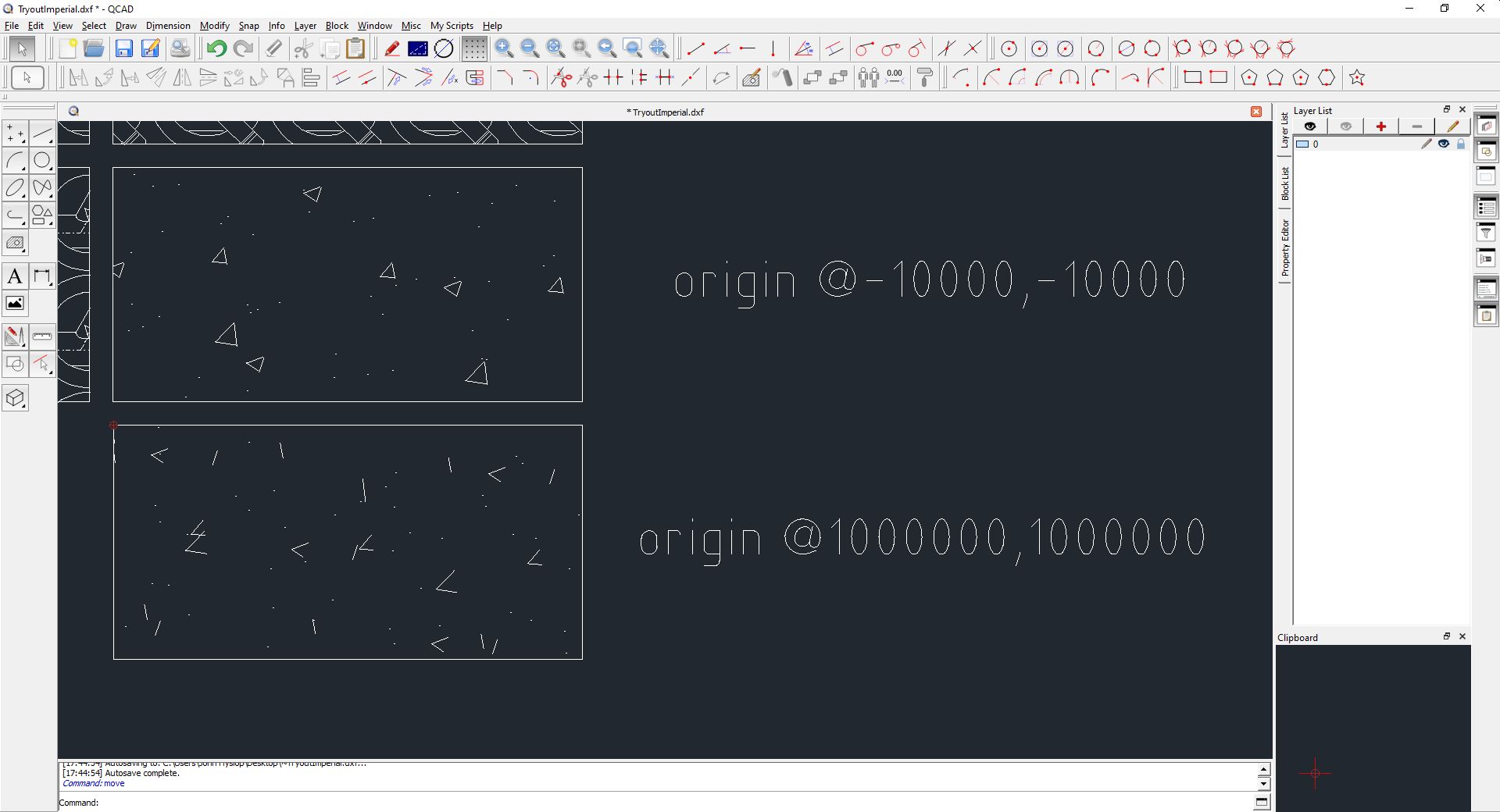

At 10000 units away from the origin it still looks ok apart from one single segment.
All other segments are also shifted somewhat but that is hardly noticeable.
Also notice the boundary crossings!! :oops:
Don't know what is going on here, that is for Andrew's to worry about.
PainterPaths is something that sits deep inside the Qcad forrest. :roll:
Why that 1 segment stands out is that it has a quite large dxshift at line 101, almost maxed out.
Instead of shifting the definition 48.79548753 one way we equally could shift it -1.41407331 the other way.
In se, that and using the endpoint is the only difference between the two pattern files apart from the name.
Included both pat files.

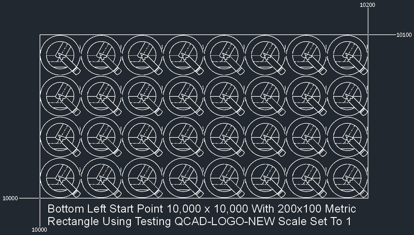

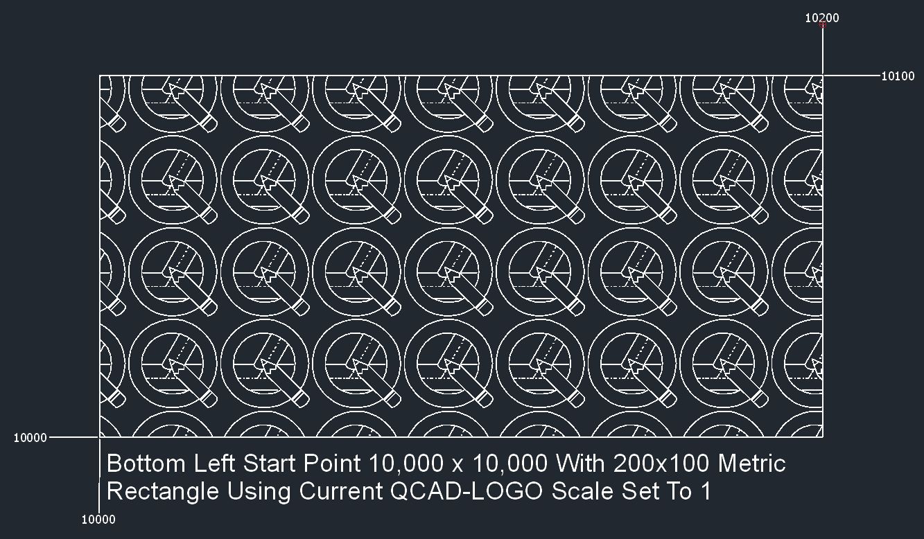

See Images Below:
QCAD-LOGO-NEW - Generated with Tile2Hatch.jpg (229.95 KiB) Viewed 28776 times
QCAD-LOGO - Generated with AC Tool.jpg (213.21 KiB) Viewed 28778 times

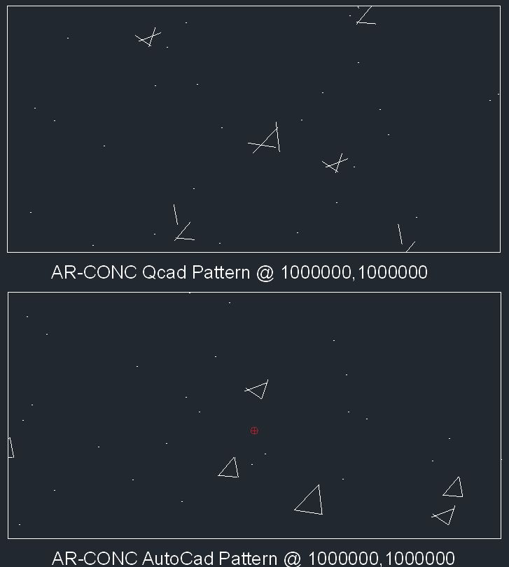

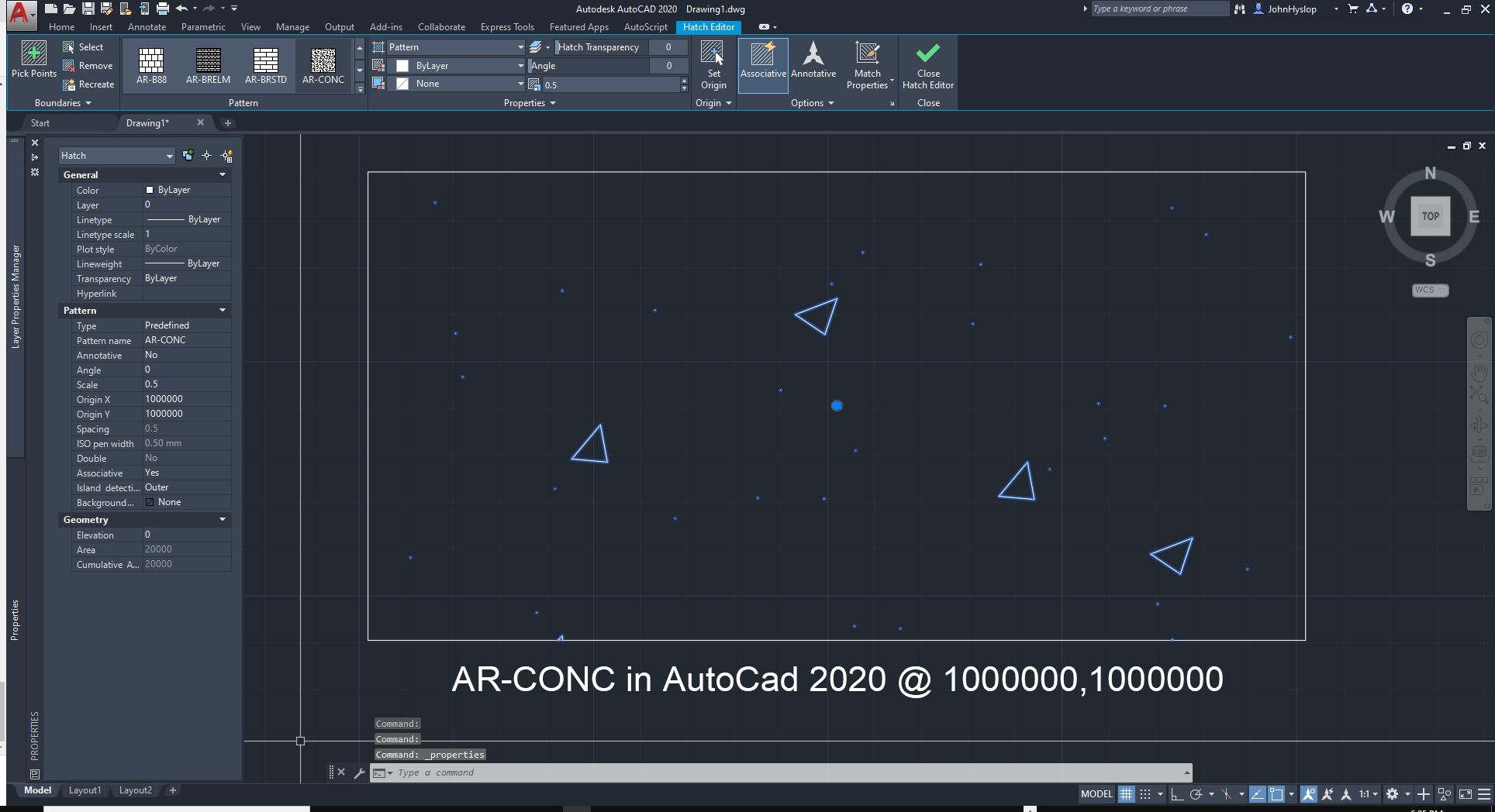

Hatch Patterns That Need to be Redone:-
Bubbles-01 ( not included in qcad build ) disaster at 100000,100000
Bubbles-02 ( not included in qcad build ) disaster at 100000,100000
Leaf-01 ( not included in qcad build ) disaster at 100000,100000
Leaf-02 ( not included in qcad build ) disaster at 100000,100000
Leaf-03 ( not included in qcad build ) disaster at 100000,100000
QCAD-LOGO ( Included in qcad build ) 1 line out of position at 100000,100000 ( but in AutoCAD is Okay? )
Squiggle-01 ( Included in qcad build ) disaster at 100000,100000
Squiggle-02 ( Included in qcad build ) disaster at 100000,100000

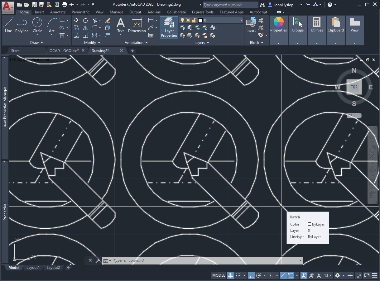

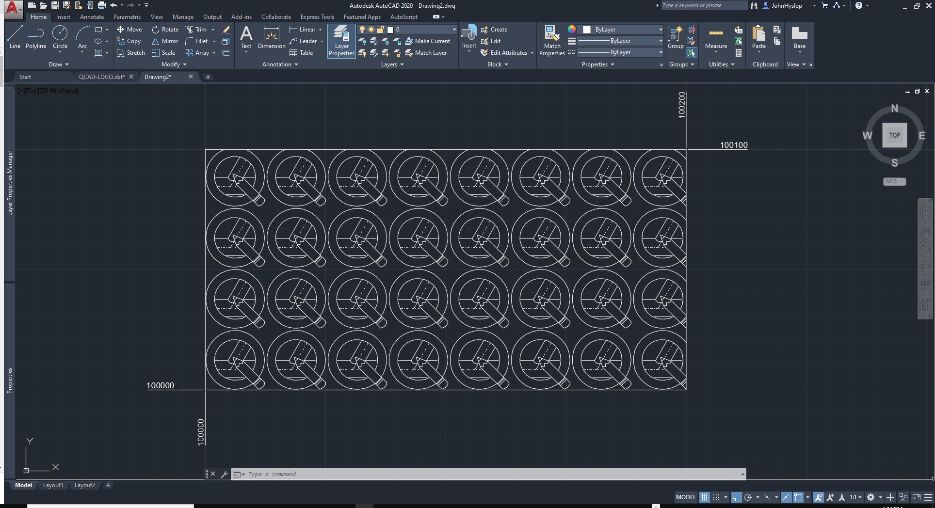

AutoCAD-QCAD-LOGO Original Created by Lisp File Closeup.jpg (140.99 KiB) Viewed 28745 times
QCAD-LOGO - in AutoCAD.jpg (249.34 KiB) Viewed 28747 times
Current QCAD-LOGO.jpg (199.2 KiB) Viewed 28761 times

dXshift Fix.dxf
(221.06 KiB) Downloaded 1311 times
This explains a lot about the shifting of line 101 of that specific QCAD-LOGO. :!:
But not why it works with a reversed dXshift....
Nor that it works plain in AC.
That could be Qcad related.... :?:

Hi CVH
I just downloaded your example dxf and QCAD-LOGOr.PAT
It has just as many errors as the original at that origin e_confused .. see
screen shot.... out of 45 patterns I've made I've removed 9 from my posts
Mainly the ones that simulate curves 8 made with Tile2Hatch and yes the AC tool is no better
in Qcad anyway QCAD-LOGO was made with this.. the rest of my patterns seem ok
Maybe dxftiles are a good idea after all, and keep patterns for basic shapes
Funny if you google about entities far away from the origin point there are lots of
problems rendering in AC etc ....Well onward and upward :-) hopefully you can work out
what is going on with the large shifts etc...
Most people wouldn't work so far away from Origin but I see your point :o

Even AR-CONC Fails at this origin and that's a standard pattern e_surprised

Hi CVH
You may of stumbled across a bug e_surprised see AR-CONC at 1000000,1000000 in AutoCAD 2020
AR-CONC - AutoCAD 2020.jpg (157.31 KiB) Viewed 28592 times

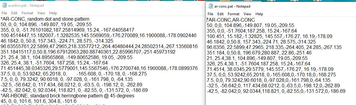

Hi CVH
Just doing some more investigations on PAT files... see the differences between the AC one and Qcad
AC have more decimal places and also as I've said before they store all there hatch patterns in one file called acadiso.pat
Cannot upload this as it has a big copyright notice at the beginning of the file ... I'll try cutting and pasting a test file to see
if Qcad renders it properly at 1000000,1000000 ...keep up the good work :)

Hi CVH
Here is an example using the AutoCad Hatch I renamed it AR-CONC2 sorry can't upload .. copyrights
Qcad still has trouble with the Triangles Yet in AC it's Perfect? e_confused
I'll keep testing :-)
Errors Connecting Triangles.jpg (30.66 KiB) Viewed 28587 times

You have a lot of reading to catch up on lol see above.... I couldn't resist opening your dxf file in autocad
look at the patterns !! what's going on here... e_confused original QCAD-LOGO and AR-CONC at 1000000,1000000
PERFECT
QCAD_LOGO in AutoCAD 2020.jpg (240.74 KiB) Viewed 28578 times
QCAD-LOGO and AR-CONC in AC.jpg (254.13 KiB) Viewed 28583 times
