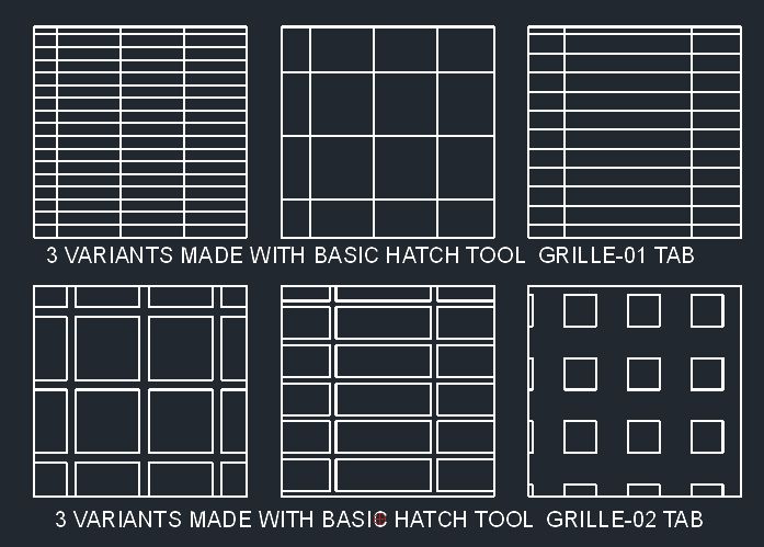

- Posts: 520

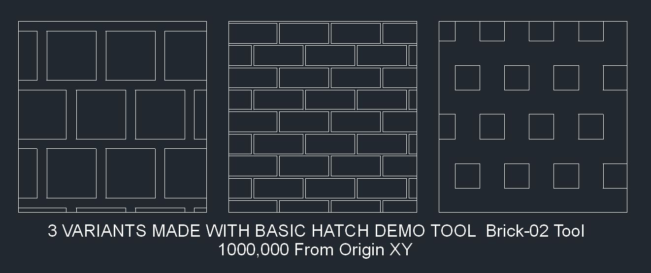

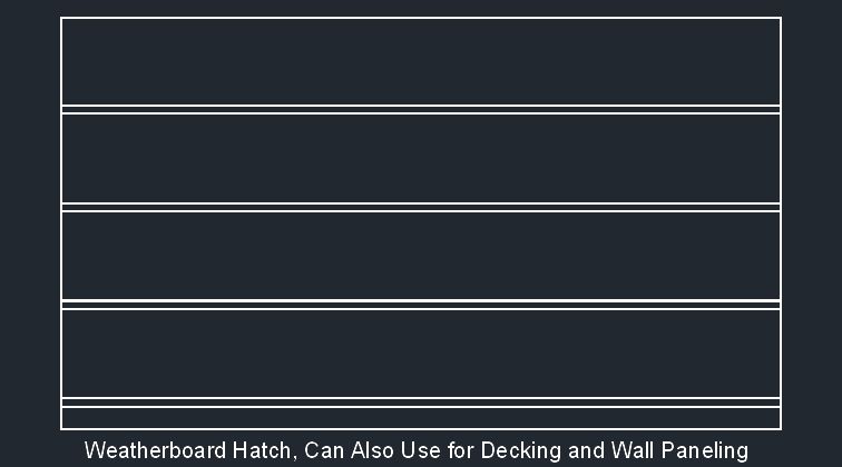

Re: Free Stand Alone Basic Hatch Pattern Tool *DEMO*

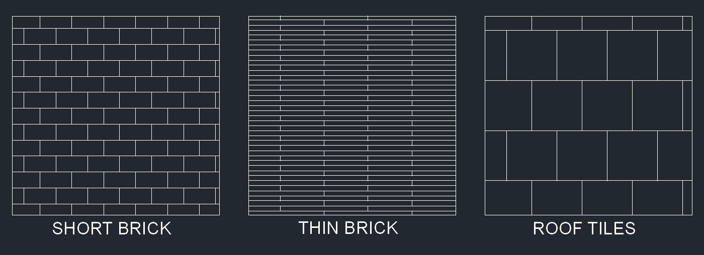

You're not limited to bricks, you can use the Brick-01 Tool to make Roof Tiles too..
Screenshot of 3 variants using "BHT-DEMO-V1.02"
Brick-02 Tool 3 variants using "BHT-DEMO-V1.04"
PS Updates Available LOOK FURTHER DOWN
- Weatherboard Hatch.jpg (18 KiB) Viewed 1763514 times
- Grille-01 - Grille-02.jpg (44.96 KiB) Viewed 1763515 times
- Brick-02 Tool.jpg (52.84 KiB) Viewed 1763561 times
- Made with Brick-01 Tool.jpg (60.62 KiB) Viewed 1763561 times

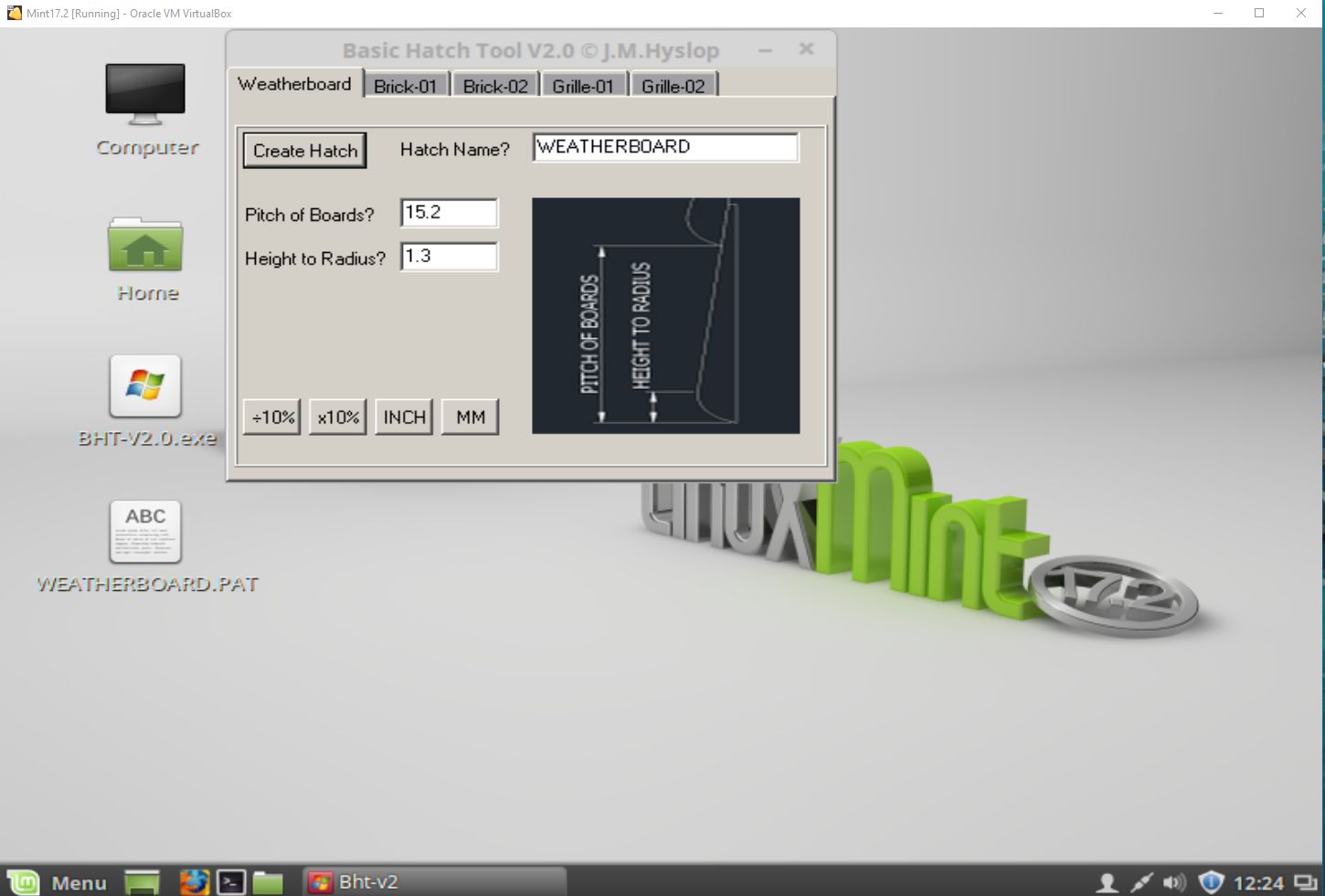

Hi All
Just Tested in MINT LINUX using WINE to run, runs fast and stable, so no need for Linux Version
- Linux MINT.jpg (79.64 KiB) Viewed 1763482 times

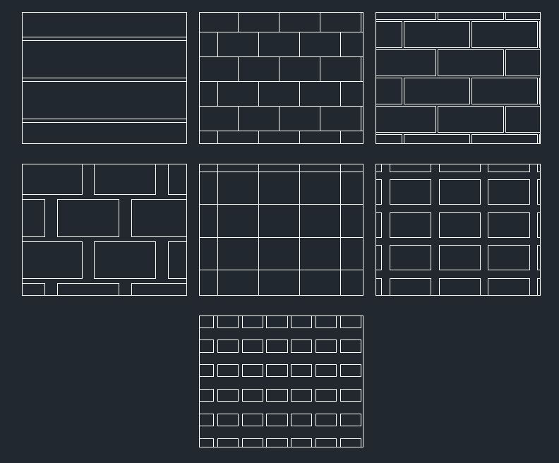

Re: Free Stand Alone Basic Hatch Pattern Tool *Full Version*

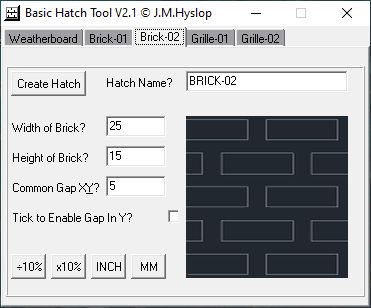

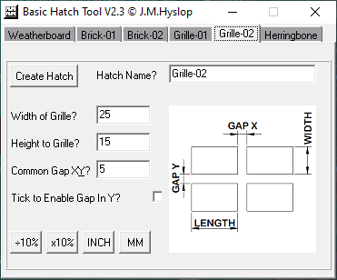

V2.1
BRICK-02 & GRILLE-02 Now Have
Option to Change Gap in Y
PS. Updates Available LOOK FURTHER ON
- Downloaded 68 Times.bmp (268 KiB) Viewed 1762459 times
- Hatch Examples.jpg (37.37 KiB) Viewed 1763360 times
- New Version.jpg (22.15 KiB) Viewed 1763360 times

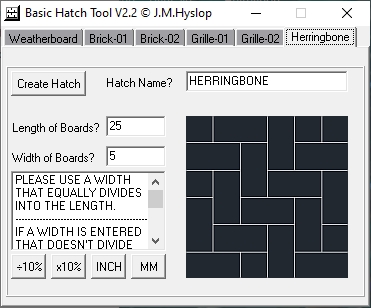

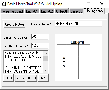

Here’s a New Version of Basic Hatch Tool Available BHT-V2.2
For Community & Professional Versions of QCAD
See Change-Log.txt & BHT-Usage.txt for Details..
Added Herringbone Hatch Pattern Limited to Ratios for the Moment,
This Generally Covers Most Commercial
Plank Sizes Most Use 1:2 , 1:3 , 1:4 , etc
I’m Not Saying That You Can’t Have Odd Lengths and Widths
I’m Just Merely Saying That The Math’s Involved in Calculating
Offsets 1000’s of Units From The Datum Gets Quite Complicated
And This Being a Basic Program as the Title States, at This Point
In Time I’m Releasing it as is, Future Releases May Include This
If a Width is Entered That Doesn't Divide Equally Into The Length The
Program Will Select The Closest Width When Saving, No Changes Will be Made to The Length...
Runs on Windows 32 & 64bit PC's [ Windows 2000 - Windows 10 ]
Runs on Linux 32 & 64bit PC's [ Tested on Mint Linux ] Needs WINE to Run
Enjoy

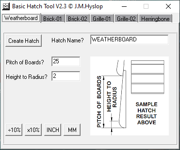

- Posts: 5054
Hi John,
thank you very much!
Question: I was going to test your Basic Hatch Tool on a Win10/64 with a 1920x1080 resolution monitor. Unfortunately it is a bit difficult to recognize the example drawings with the annotations. Do I have any possibility's to enlarge the tool window?
- Posts: 520

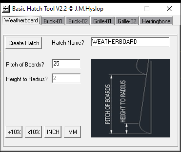

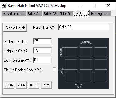

Hi Husky
I added the drawings as a visual reference..
I will have a go at making them a bit clearer..
To change the width of the actual application would require me to reprogram... The text seems quite clear though...lets see what happens when i redo to images... I made it compact so it wouldn't take up too much screen..
I'll try tomorrow , night time here... I'll send via PM
with update In case it doesn't work...
Thanks for testing ....
PS That's the same resolution I'm using...
It is a bit fuzzy now i look at it without my glasses lol... I'll make the images larger/zoomed in.. If you think that would help?
- Posts: 5054
Yes I know and I think that is a good idea ...
To my knowledge often are svg used to represent icons etc.. As you know - svg's are tolerant to size changes ...
Except the visual references the rest of the GUI is Ok in my opinion.John Hyslop wrote: ↑Wed Aug 12, 2020 9:53 amTo change the width of the actual application would require me to reprogram... The text seems quite clear though...lets see what happens when i redo to images... I made it compact so it wouldn't take up too much screen..:-)ages larger/zoomed in.. If you think that would help?
Normally I work without glasses on my Monitor. Your program forced me to wear glasses AND use a magnifier what made me thinking: Something is different here ...John Hyslop wrote: ↑Wed Aug 12, 2020 9:53 amIt is a bit fuzzy now i look at it without my glasses lol... I'll make the images larger/zoomed in.. If you think that would help?
- Posts: 520
Hi Husky
LOL ... I was paying too much attention to the workings of the program
As Requested here is a newer version, much clearer...thanks for picking this up..

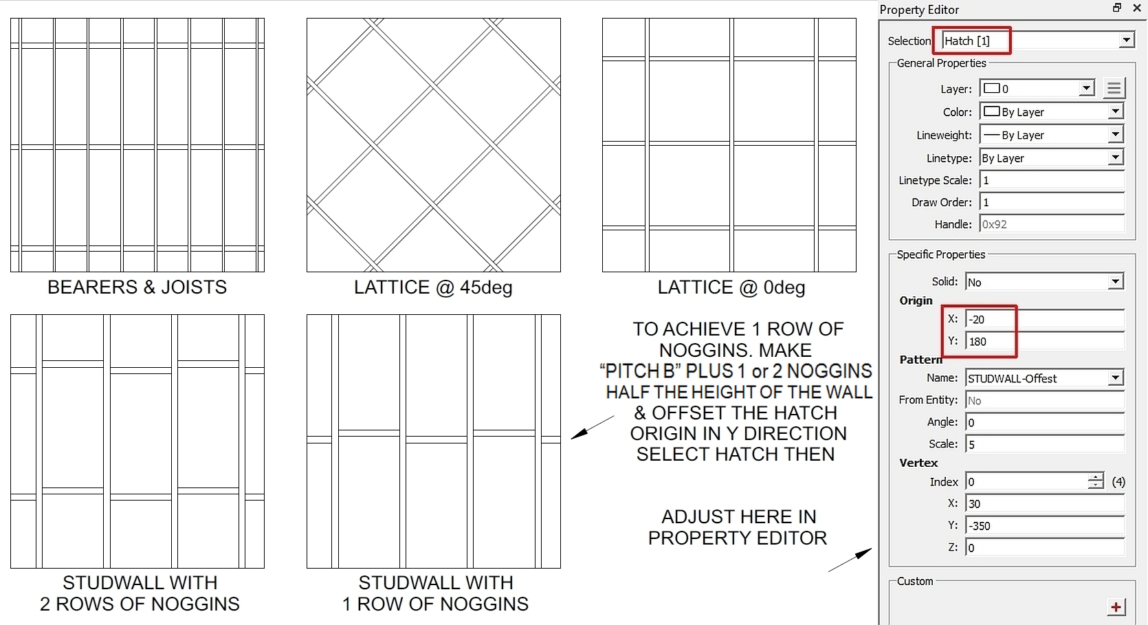

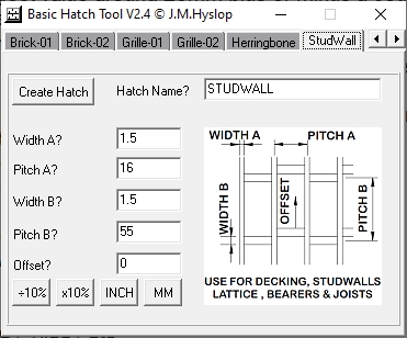

- Posts: 520
Hi All
Well 1st of all many thanks to Husky for suggesting the new StudWall Tab
New Version BHT-V2.4.1
BHT-V2.4 Has been Dowloaded 11 Times I've Now Included a PDF
Tutorial on Using The StudWall Tool Now in the zip file and also separately
for those who have already downloaded the Tool, PDF 2 Posts Down
PS Updates Available LOOK FURTHER DOWN Here are some other things you can make with " Basic Hatch Tool " Hatches
Weatherboard = Decking / Paneled Walls / Flooring / Equally Paced Lines ( Make Radius Half of Pitch )
Brick-01 = Paving / Roof Tiles / Flooring / etc
Brick-02 = Paving / Roof Tiles / Bathroom Tiles / Flooring / Lattice / Decking / etc
Grille-01 = Wire Fences / Paving / Tiles / etc
Grille-02 = Fences / Paving / Tiles / Decking / Flooring / Lattice / etc
Herringbone = Pretty Much as is with limitations at the moment, length must be divisible by width.
StudWall = Decking / Lattice / Bearers & Joists / etc
I also adjusted the X & Y Origins to make it fit better in the square box, if the hatch touches the edges of the hatch area you can dimension it to find out how much to move it if required, you can also use keyboard hotkeys IP (Menu> info > distance point to point)
Please Read the BTH-Usage.txt file supplied with Zip, It contains important information about
using the Tool..
Enjoy
Just Updated V2.4 to V2.4.1 Added Message "Incorrect Offset Entered" in StudWall Tab
You can continue to save but it will be incorrect, Just select NO on save and fix incorrect input..
The next version will not give you the option to save if you enter a negative value but
I need to create a subroutine for this on all patterns so I'll fix on next release
PS Just corrected name of PDF file to Studwall instead of SudWall
Oops

Hi All
Here's a short tutorial on using the StudWall Part of my Basic Hatch Pattern Tool..
I hope this helps, thanks to Husky again for pointing out that some explanations are needed
so people understand how this works... enjoy
Adding Searchable names Stud Wall , stud wall , stud-wall , stud_wall , Stud-Wall , StudWalls , studwalls ,

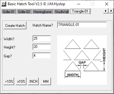

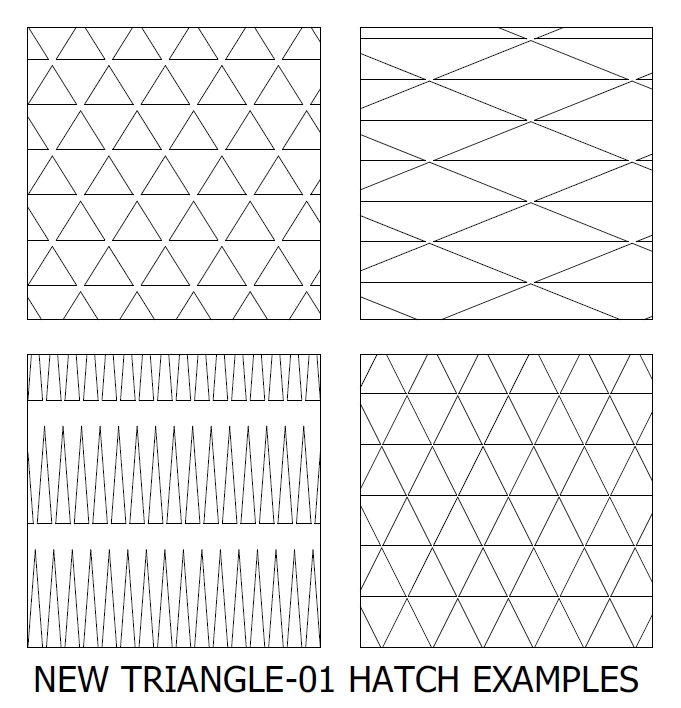

Hi All
Version 2.5 Available with new Triangle-01 Hatch Pattern
That's a Total of 8 Configurable Hatch Patterns
See examples below:-
And It Holds Reasonable Tolerance at 1 million Units from Datum
Enjoy
PS Update Available Look Further Down
V2.5 Downloaded 3 times..
Enjoy
