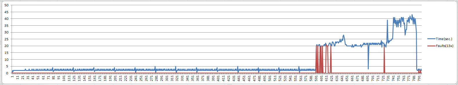

- Speed:
To start, the script needs on average 3sec for every move.
After the first fault (592/797), that jumps to 20sec per move.
At 742/797 that rises to 40sec per move.
At 786/797 it drops back to 3sec per move.
Even with 2 additional faults untill all were moved.

In the revision:
Troubled by: :shock:
- There are 6 with Block names reported not visible in the Block List
13 not moved: :(
I presumed that 'failing the move' was merely NOT moving ...? :shock:
[SOLVED]
Block names in upper case starting with an asterisk '*'
- not equal to RBlock.modelSpaceName in upper case
- not starting with '*PAPER_SPACE'
Are considerd INVALID.
See: BlockFixNames.js
The 'Quarantine hatches' script now includes a test for this and will report this at the end. :P
> Found invalid block names !
> Before saving the file use Menu .. Misc .. Block .. Fix Block Names.
Fri Nov 27, 2020 2:00 pm
Managed to do them one by one.
In the report I see that 13 individual hatches didn't move ... 'Transaction failed....'
[SOLVED]
This tickle down to another level of visibility, the RObject itself being set 'Invisible'.
Supported by QCAD on load and an unknown property for QCAD users BUT also cleared :!: while saving.
Solved moving with: setAllowAll(true) & setAllowInvisible(true) for the operation.
See: REntity.cpp

Tue Dec 01, 2020 1:47 am
- RunTime:
The script ran the last test(#7) from 08:54:51 to 10:41:04 or 1h 46m 13s in total.
[SOLVED]
Moving all as one single operation, and without the failures, the runtime is about 1m 13s (or a 98,85% reduction :D ).
- less than a second for gathering information on 797 hatches and reporting 13 as invisible.
- 20 milliseconds to create 13 sublayers. (also 13 and purely a coincidence)
- 18 seconds to apply the operation and update the GUI.
- 9 seconds to move 797 hatches and reporting each individual. (EAction.handleUser.... to the command history is not so fast)
- 45 seconds to apply the operation and update the GUI.
:? Applying the operations and updating the GUI needs 86% of the total run time.
And that is about the same as merely freezing or locking one layer.
