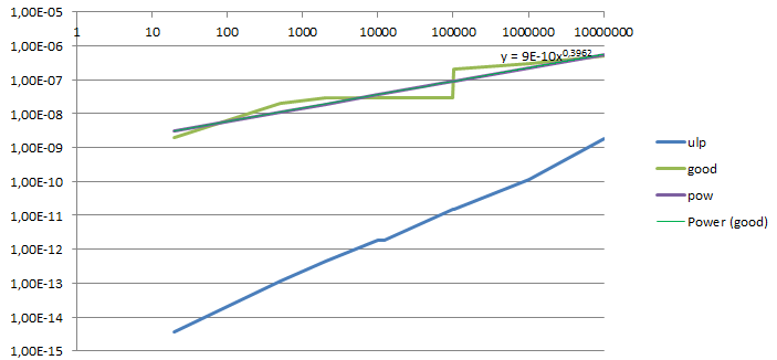

Post by CVH » Sun Jul 18, 2021 11:23 am
Andrew, All,
Based on a wide survey ... (0 ... 10,000,000)
Filtering all false positives from an RPolyline.getSelfIntersectionPoints() list ...
Including for troublesome bulging polylines ...
Ignoring the bulge factors to arc shapes floating point uncertanties ...
But simply based on the largest absolute X or Y value of a box surrounding the polyline ...
var box = entity.getBoundingBox();
var maxNumber = Math.max(Math.abs(box.c1.x), Math.abs(box.c1.y), Math.abs(box.c2.x), Math.abs(box.c2.y));
var tolerance = 4.00e-9 * Math.pow(maxNumber, 0.45);
# Edited # Forgot a safety margin ... :oops:
This is based on the equation of a trend line of filtered results without false positives.
One may remark that:
- 4.00e-9 is 4x RS.PointTolerance.
- To power 0.45 is almost the root.
Bottom line: The required tolerance value is governed by the Floating Point uncertainty of the coordinate values.
