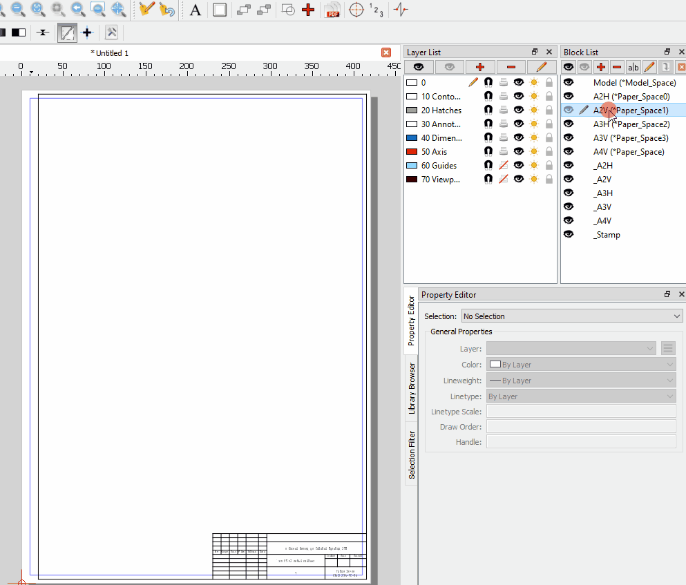

To duplicate the layout block, right-click on the desired layout block and select Duplicate Layout Block from the context menu
Re: Duplicate Layout Block
Posted: Sat Jan 15, 2022 5:16 am
by dmitpon
