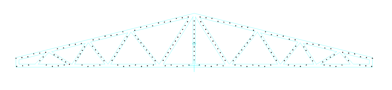

Hi guys, I am working on a project that requires me the generate a list of x-y coordinates based on a dxf file. We need to mark a spot on the truss where to place nails. (see photo). I'm used cad/cam pro and the output will be to a g-code file.
The idea is that I would select a line from the view and click generate. That script would generate a pattern of point along the axis with offset and spacing according to the settings. writing to code and the math isn't the problem. (Even though I will come back to you for help.) The issue is how to incorporate the tools into Qcad. Where do I start to build a plugin with required toolbar and dialog windows to set parameters.

After a couple hours I was able to build this (see Zip) to add points to the drawing. I want to know best practices to have global settings. I have the menu structure the way I want it, but I want to menu items to show up as buttons on the toolbar too. Code is still messy to don't read to much into it.
steps.
Load File (80TRUSS_Import.dxf)
Init Truss (To make sure drawing is exploded)
Select Truss Top Chord and click button. (draw points along top chord.)
Select Truss Web and click button. (draw point along truss webs.)
deselect all.
click menu item Truss bottom Chord / Select left bottom point / move mouse along bottom line and add point as needed.
Re: Custom tool design

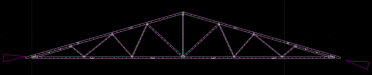

So, Thanks for your help on creating this tool. I forgot has much fun it is to write code. Anyways, I will be sending this to the customer to find bugs. :) (trust me they will) But it should get the job done. Overall I'd say it's a great platform for custom dxf based tools.
So if anyone wants to test it, I included a dxf file from the said customer, 495_test.dxf.
Step one. Open the file.
Step two. Click the INIT button to create nails layer and hide / lock others.
Step three. Add nails to bottom chords with Chord buttons... mirrored works great. (adds custom property for sort order.)
Step four. Add webs nails with web tools. (mirrored tool has to make one line down to middle and then mirrors out from there.
Step five. Set the Zero point and export to CVS file.
:D

3. The drawing has 1294 duplicates and 152 Zero-length entities. Is that on purpose?

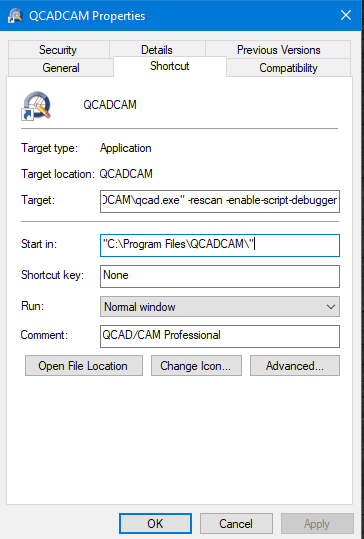

1. I have Qcad/cam version 3.27.8.0 (3.27.8) and I have the nTruss Folder in the scripts folder.....

3. The drawing came that way from the supplier..... I will have to work with it the way it is....
