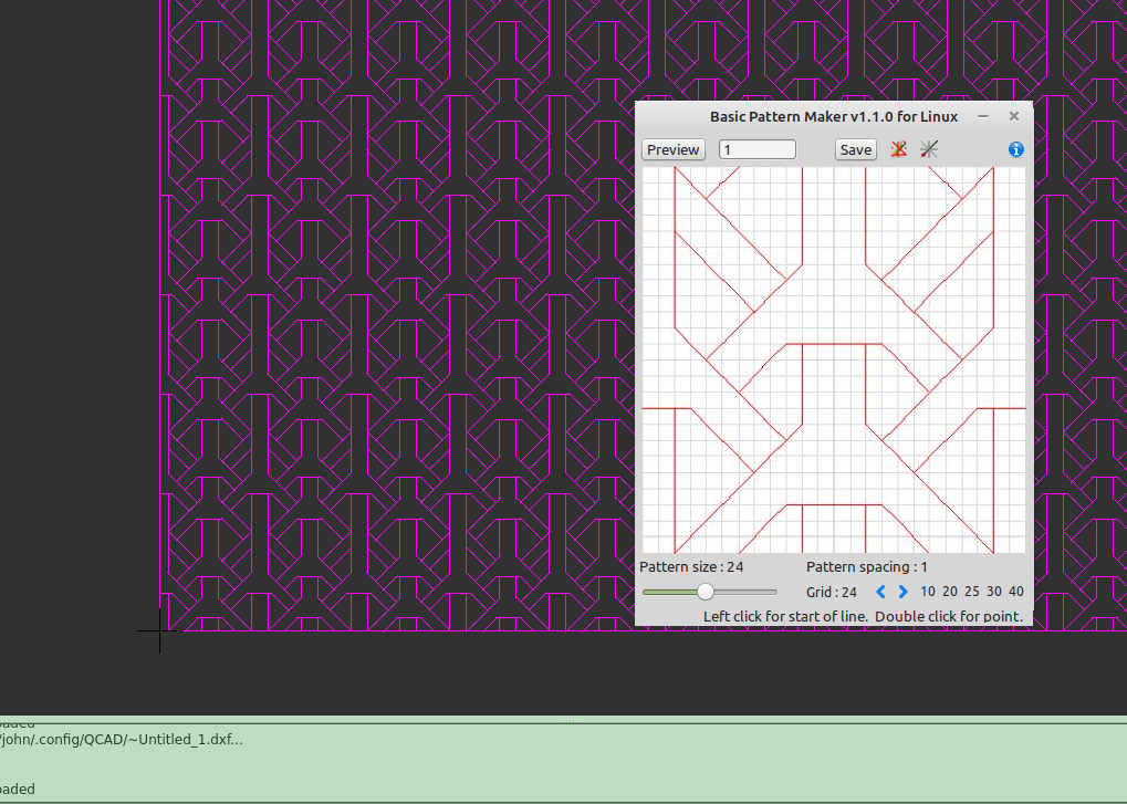

Hi all
It's been a while since I've posted so hopefully you'll all like this one :)
I was working on this very simple pattern maker and PeteVick asked me if I was interested in sharing the code because my compiler was limited to Windows only Apps and he uses Lazarus [ Pascal ] that can compile to both systems... so I said yes and I have to say I'm very pleased with the end results.
After Pete ported my code across he added quite a few more enhancements.. :D "plus we've enjoyed a bit of banter in the process..."
So just letting you all know this was very much a joint effort..
I would also like to thank JJ who did some testing and feedback on the original.. and Husky who has picked up on so many errors and bugs in the past couple of months... Many Thanks :)
BPM for now is Limited to Points & Angles 0,45,90,135,180,225,270 & 315
Here are some App screenshots...

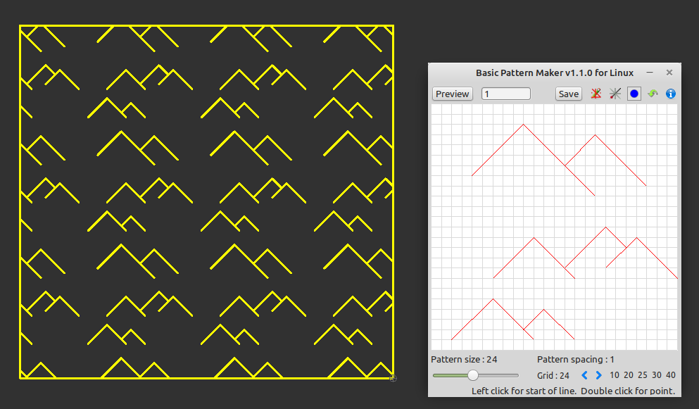

BPM - Mountains.png (38.05 KiB) Viewed 110959 times

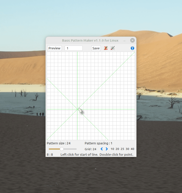

Re: Basic Pattern Maker [ Windows & Linux ]
Posted: Sat Jul 08, 2023 4:19 pm
by lphilpot
Question - On my Windows 11 two-monitor computer it always starts in the dead middle, split between the two monitors. Is there a way to make it remember its last position or specify display geometry?
Thanks.
Posted: Sat Jul 08, 2023 10:51 pm
by John Hyslop
Hi Len
We initially had some trouble with window positioning the preview window was going off the screen and there was no way to grab the tool bar to drag it into position.
I have a two monitor set-up but I run Linux Mint and don't have this problem, we'll have a look at this as there are settings for the positioning.. I'll try running my windows VM on two screens to see what happens, it could also be a Windows 11 thing BPM hasn't been tested on 11..
Meanwhile you could Google this "MultiMonitorTool"
Thanks for the feedback..
PS I've not tested MultiMonitorTool but it's free and has a 4/5 star review.. Hopefully it gets you out of trouble for now..
Posted: Sun Jul 09, 2023 8:15 am
by John Hyslop
Hi All
Thanks Len for picking this up...
There was a problem with dual monitor setups, the App would open split between the two monitors.. e_surprised
New V1.3.4 Updates below.. there is no need to update if you're a single monitor user..
Linux users please uninstall old version 1.1.0 "if you have it installed" as these are now deb packages browse to home/username/Basic Pattern Maker/Basic Pattern Maker Uninstall
To uninstall deb versions type this in the terminal:-
sudo apt remove basic-pattern-maker
NEW Version Uploaded Look Further On

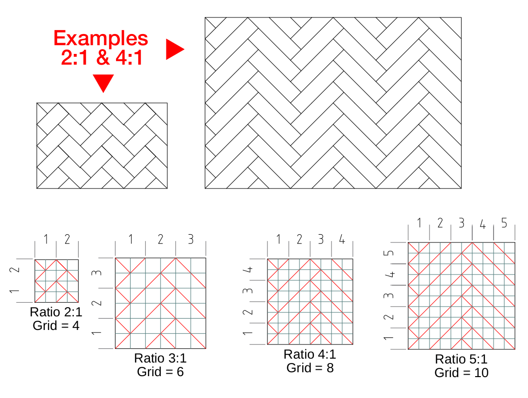

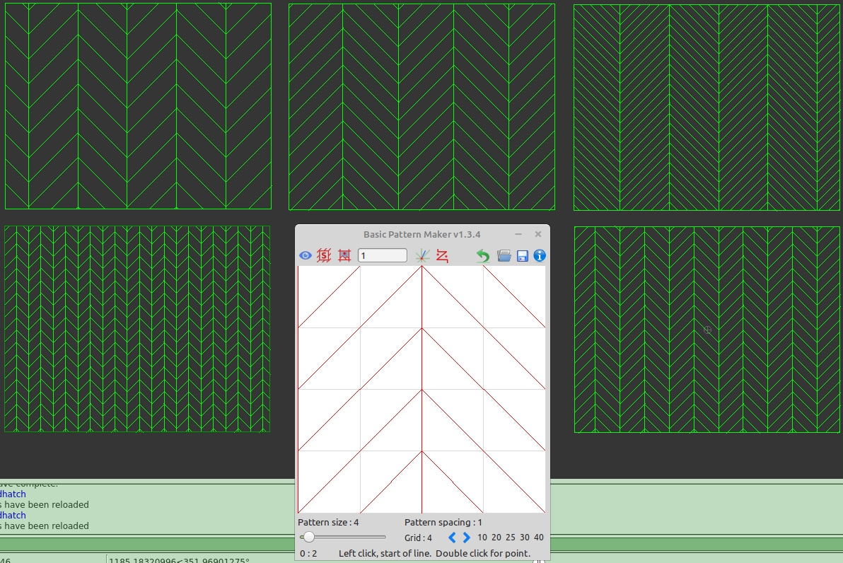

Posted: Mon Sep 18, 2023 10:05 am
by John Hyslop
OK I know you’re all just itching to try something different with our “Basic Pattern Maker” :lol:
Well how about this then, Herringbone patterns “limited to ratios with lengths being dividable by the widths”.
Basic Pattern Maker has a grid limit of 50 so the largest ratio will be 1:25 “the grid needs to always be at least double the ratio”.
Most “not all” commercial paving bricks and boards have common ratios, the reason being is they are easier to work with and they line up with walls in rooms and patios perfectly where uneven ratios don’t.
And before anyone says anything... sure you can do it at 90deg instead of 45.. but it's a lot easier doing at 45deg if you stick with the rules above :)
Happy Hatching :)
John & Pete
Posted: Tue Sep 26, 2023 5:17 am
by John Hyslop
Hi All
Here's another hatch pattern that can be made with out "Basic Pattern Maker"
For all you "Chevron" fans out there :lol:
Happy Hatching
John & Pete..
PS Use different size even number grids for longer or shorter boards :wink:

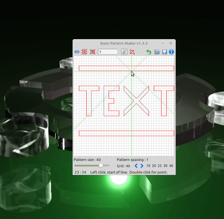

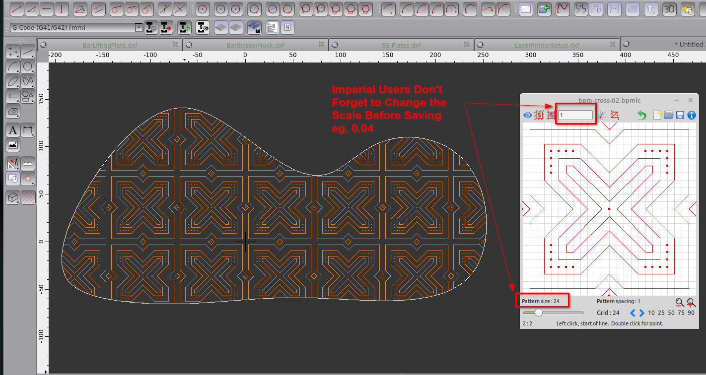

Posted: Sun Jan 28, 2024 3:52 am
by John Hyslop
Hi All
Was just playing around today with this very basic pattern , it's a good example of the use of lines and points in BPM..
Here's a copy of the sketch file [ *.bpmlc ]
bpm-cross-02.bpmlc.zip
(1.1 KiB) Downloaded 2386 times
Happy Hatching :D
John & Pete

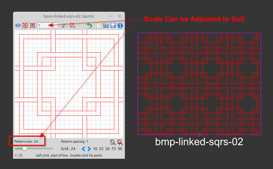

Posted: Mon Feb 12, 2024 9:23 am
by John Hyslop
Hi All
Here's another sketch file for "Basic Pattern Maker" interlocking squares. :lol:
bpm-linked-sqrs-02.zip
(813 Bytes) Downloaded 2097 times
Happy Hatching
