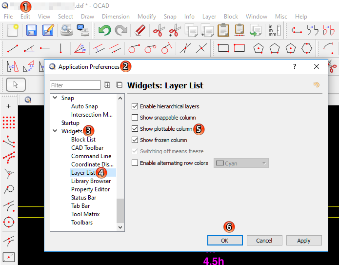

So how do you use the print/don't print layer feature?
I can only toggle visibility and/or lock.
I expect to be able to see a layer on the screen but be able to set it so that it will not print.
Thanks.
Re: Print Preview / not plottable
Posted: Tue Mar 26, 2019 1:06 am
ssobol wrote:
Mon Mar 25, 2019 10:49 pm
Correct and you can't see them in "Print Preview.
You will find the settings for "Plottable" in the Layer Dialog (New- or Edit Layer).
Below "Application Preferences" is the possibility given to make the "Plottable column" visible in the Layer List ...
... and it will look like this:
Posted: Mon Apr 01, 2019 12:32 pm
by Panchdara
That is cool! I like that. Husky, you must know all the "QCAD Wonders of the World". :D
Oh, need to restart QCAD once preferences have been set.
