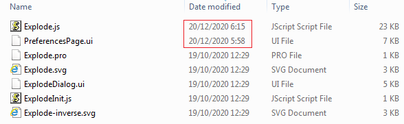

I proposed a flag in AppPrefs .. Modify .. Explode to avoid explosion of circles.
https://qcad.org/bugtracker/index.php?d ... sk_id=2156
In the end it looked to easy to not adapt it myself.
File revisions are included in the proposition.
To include this for yourself you need to have/create the full folder structure: ..\QCAD\scripts\Modify\Explode\...
I placed all the files from the master branch on GitHub in the 'Explode' folder.
Then I overwritten the two by the new ones.
Final implementation is up to Andrew. :wink:

You could install the files, it was a minor change.
You could vote for it.
Or hold your horses, it is getting better. :wink:
