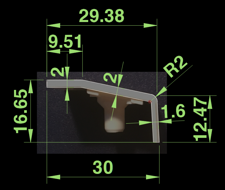

Re: Novice: Drawing around an imported image?
Post by Husky » Mon May 31, 2021 8:49 pm
terrypin wrote:
Mon May 31, 2021 11:31 am
Perhaps this sort of task is outside QCAD's scope?
Nope ..... it is no problem for QCAD if you know how to use the provided tools in QCAD. Trying to solve this task with multiple different software solution like Paint Pro, Incscape etc etc opens many ways for an inaccurate result.
This example is simply based on the correctness of your 30 mm measurement ....
terrypin
Posts: 9
Joined: Sun May 30, 2021 12:18 pm
Post by terrypin » Mon May 31, 2021 10:51 pm
Brilliant, thanks! I’ll try those estimated dimensions ASAP.
But, as you’ll have gathered from my initial post (and my subject heading beginning ‘Novice:’), what I really want is to learn how
Your screenshot is tantalising! Can you amplify on what steps I have to take to reproduce it please? Or point me to a guide or tutorial? I don’t want to spend a month or three learning how to use QCAD’s entire feature set. Just those parts that will let me achieve the modest objective I described.
First - you have to learn how to scale (Scale SZ) a bitmap to "Real world" measurements. It is explained many times in this forum.
Then get familiar with a handful of QCAD tools like:
Vertical Line LV
Horizontal Line LH
Line from 2 Points LI
Parallel (with Distance) LP
Round RN
Trim Both TM
I used them for this example but there is always more than one way to skin a cat ... :wink:
