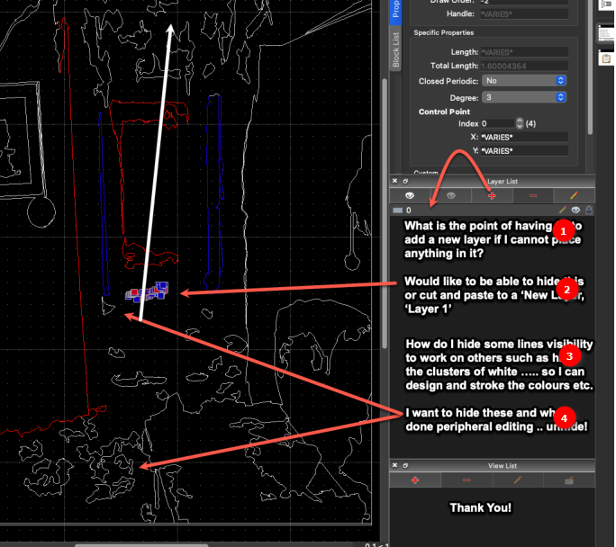

In regards to your tutorial response I did not grasp the concept in regards to layers. I don't understand the concept of 'Draw Order with a DXF that doesn't have a BG. I've included an attachment outlining what I need help with to get started...... Also I don't know what a block is and what it refers to.... Also, is an Entity a single path or curve. For the most part I need to be able to do what is in the attached PDF. I have been contacted by some Vancouver Forum members today and hopefully some assistance can come from them.
Andrew is it ok to give my direct information on the forum / and hire a willing participant?
See attached PDF.

Post by andrew » Mon Jun 26, 2023 7:02 am
The discount for the e-book on our website applies only to the software + e-book bundle. I've sent you a primate message with a discount code to purchase the e-book at a 50% discount.
To place a selection on a layer:
- Add the layer, e.g. "Layer 1"
- Select the entities (= drawing objects)
- In the property editor, change the layer, e.g. from "0" to "Layer 1"
One your entities are on a separate layer, you can hide them by hiding the layer:
- Click the eye-icon in the layer list, next to the layer you want to hide
As far as I can tell, you will not need blocks (named, reusable groups) for what you are trying to do.

Post by Husky » Mon Jun 26, 2023 7:58 am
@ Davyj , regarding your attached pdf:
1.: This + is meant to create a new but virgin layer. Ready to be filled by you creativity ... :wink:
2.: Select what needs to be moved to a new layer, Check Property Editor, move selection to a new layer. You then are able to toggle the visibility for this layer.
3+4.: Every entity (lines, arcs, circles bitmaps etc etc) is on a layer. How to organize those layer is your job. The visibility on those entities can be toggled e.g. with the Eye icon in the layer list
Edit:
For demonstration purposes I modified your 17.dxf example. I moved all blue lines to layer Blue Lines. Play with the Eye icon in the Layer List to toggle the visibility of those blue lines ...
If the Layer List isn't launched by now you can do that below Menu/View/Layer List
17_mod.dxf
(1.11 MiB) Downloaded 580 times

Post by Davyj » Tue Jun 27, 2023 12:27 am
Thank you,
This is precisely what I needed to know / learn...... I will give it a go!
In the event that I have another question I will use the PM section.
