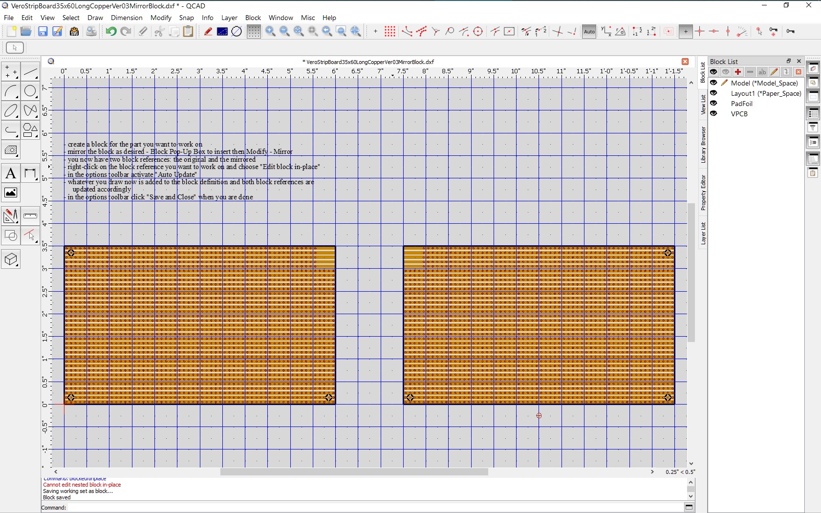

You can see in the attached screen shot that I was able to use Edit Block In Place to erase the mounting hole and some other holes (red) in an upper corner of one instance of the Block and when I clicked on Save and Close the other instance had the same changes, IN MIRROR REVERSE. PERFECT!
- EditBlockInPlace.jpg (685.41 KiB) Viewed 12231 times
I was confused about the Options Toolbar at first, but found out it is an interactive toolbar. No sub-commands show up until you reach the point where they can be used. Drove me nuts for a while until I noticed that. But that seems to work too and the Auto Update seems to stay active when I Save and Close and then restart the Edit Block in Place. This is going to be very helpful. My next step with this project is to add the schematic above one instance of the circuit board and then do the parts layout. I love the way this is going. Need to brush up on using a parts library now.
