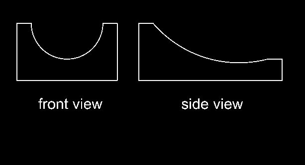

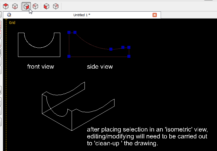

To use the 'Isometric Projection' tool - front, side or top views would be drawn in the normal way (no special methods etc...) then simply select all or part of a view (or any single entity, object for that matter) from your drawing and follow the prompts in the status bar.
orthographic front and side view.png (2.17 KiB) Viewed 36504 times
1. Select for example side view (see snap shot).
2. Select reference point.
3. From the 'isometric' options (top,bottom,front,right etc.) select the isometric plane you wish to use (my example = right).
4. Place your selection.
5. Clean-up your drawing with the edit/modify tools etc...
isometric view.png (13.33 KiB) Viewed 36504 times

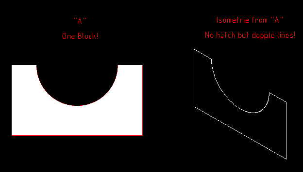

Hi together
I have a question to this topic .... 8)
Based on your drawing: If I use this shape with a solid hatch, put this into a block and try to create an isometric I will get an Isometric without the hatch but with double lines.
Is that how it should be? Why is the hatch lost but I have still the double lines from the hatch contour? It works fine without a block ..... 8)

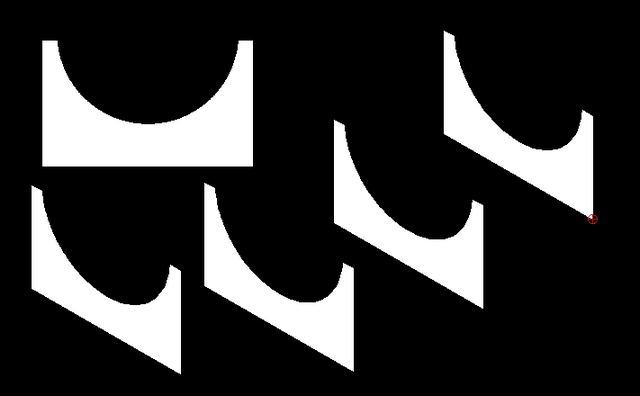

Try this
1.Draw shape.
2.Select and hatch.
3.Now un-select first to exit hatch command!
(Edit: or click on screen/unselect after block creation)
4.Then select again and use Isometric Projection tool (PJ).
iso hatch test.png (18.79 KiB) Viewed 36458 times

Thanks for your effort but that is not the problem. My problem is based in the "Block isometric scenario" with a result of "No hatch but double lines".
Re: How do I use the Isometric Tool?
Posted: Mon Oct 08, 2012 10:13 pm
by Clive
Agreed - I see what you are saying now :) !
Workaround
Explode the block to release all the 'control' points then use the iso tool to move the outline and hatching into an isometric projection.
Its not ideal but it works for now.
Something to be added to the feature requests I think :wink:
