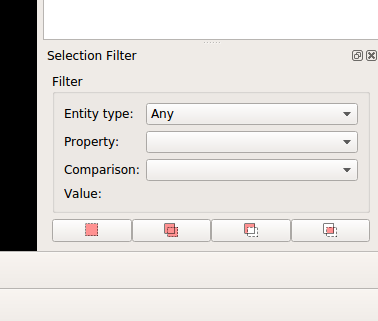

Yes, I mean using View > Selection filter. I don't see any "Custom Property" option in the Selection Filter "Property" menu, so I guess it is not possible right now, at least without scripting specific command to do that.
Regards, David.

dfriasb wrote:I don't see any "Custom Property" option in the Selection Filter "Property" menu, so I guess it is not possible right now, at least without scripting specific command to do that.
Yes, that's correct.
I've added a feature request at:
http://www.qcad.org/bugtracker/index.ph ... sk_id=1596
