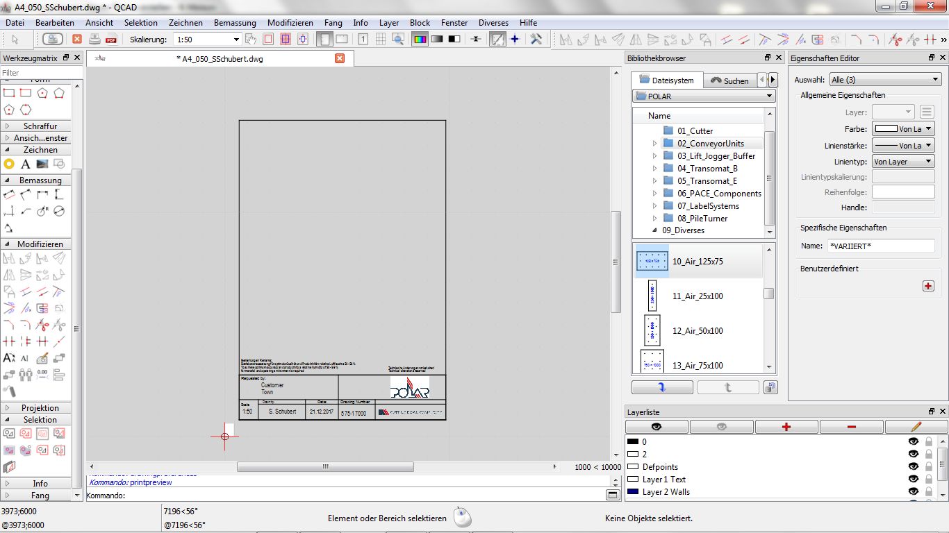

My standard unit is mm, so everything is set to mm. Sometimes I have to do a dimension in inch or mm/inch. After Husky told me about the ability to write something after <> mm I thought it should be easy. So I made the drawing, put the dimensions on them and wrote the mm value after the two symbols <> 1250 mm. Now as I don't like to calculate the feet/inches from my mm I just changed the drawing settings from mm to inch and the dimension settings from dezimal to technical and I get 104' - 2" 1250 mm. Alright everything ok, but after I tried to print the drawing I end up in a mess.
My drawing is shrinking and off the drawing sheet....
I simply do not understand what is happening here. Any suggestions?

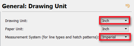

If you are already doing that make also sure that the "Measurement System (for line types and hatch patterns) is set to the correct system - avoids headache in the long run. :wink:
e.g. Drawing Unit mm = metric, Drawing Unit inch = imperial
