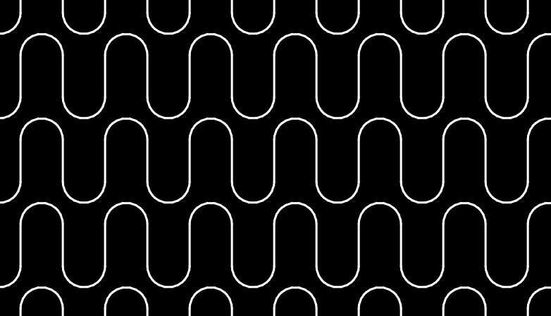

Hi again.
I have attached an example of a dxf file that would be great to use as a hatch pattern. Looks like this:
Thanks for helping out.

First: A Hatch consists of line pieces, nothing else.
But there are ways arround that so it looks as rounded.
Further: Please also indicate the repetitive nature.
Remember this has to fill everything in all directions up to the boundary and in all scales.
Lets say 3-4 repetitions in the desired directions at least.
Did thought it would going to be a hard one, offcourse.
Never mind.
Re: How to create a custom hatch?
Posted: Thu Nov 21, 2019 11:30 pm
by CVH
Got the repetive nature by PM.
Simply 10 up/down and 10 aside.
For start, we have two verticals that repeat up/down.
With angle = 90, start (x,y), on state, off state (magenta).
The offset along the line is 0 and the ortho offset is 10.
Kept it simple and approximated the arcs by 9 segments. :|

The 6 chords and most we need can simply be moved, mirrored and/or rotated 180. e_geek
That will give us 24 chord segments.
With angle, start (x,y), on state, off state (magenta).
Turns out that the arcs are finally approximated by 13 segments.
Now it is simply the question to add the offset along the line (dark yellow) and the ortho offset (yellow) for each.
I used the shape 1 above to determine these values.
:!: When I stepped across by 2 or by 3 the definitions have to be repeated by posX+10 and by posX+10 and posX+20.
In the vertical direction I only stepped by 1, so there is no need to repeat definitions in that direction.
The file is called <Test_MPN.pat>.
