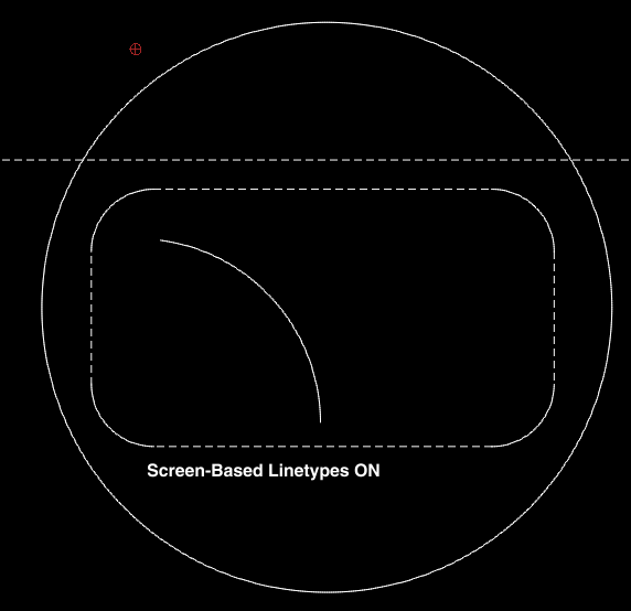

Going to hijack this topic for a moment ... :shock:
bambuko wrote:
Wed Sep 01, 2021 10:18 am
I am using dashed line, Dashed (.5x) to be precise, scaled at 0.1 to draw some lines and circles.
Lines display OK, but circles appear solid and not dashed :?
I am confused...
Yep, that annoys me for some time too ...
All entities are on the same layer, Dashed .5, 0.35, no scale, Screen-Based Line-types mode "ON", unfortunately (confusingly!) correct rendering fails for arcs and circles.
dashed.dxf
(102.77 KiB) Downloaded 834 times

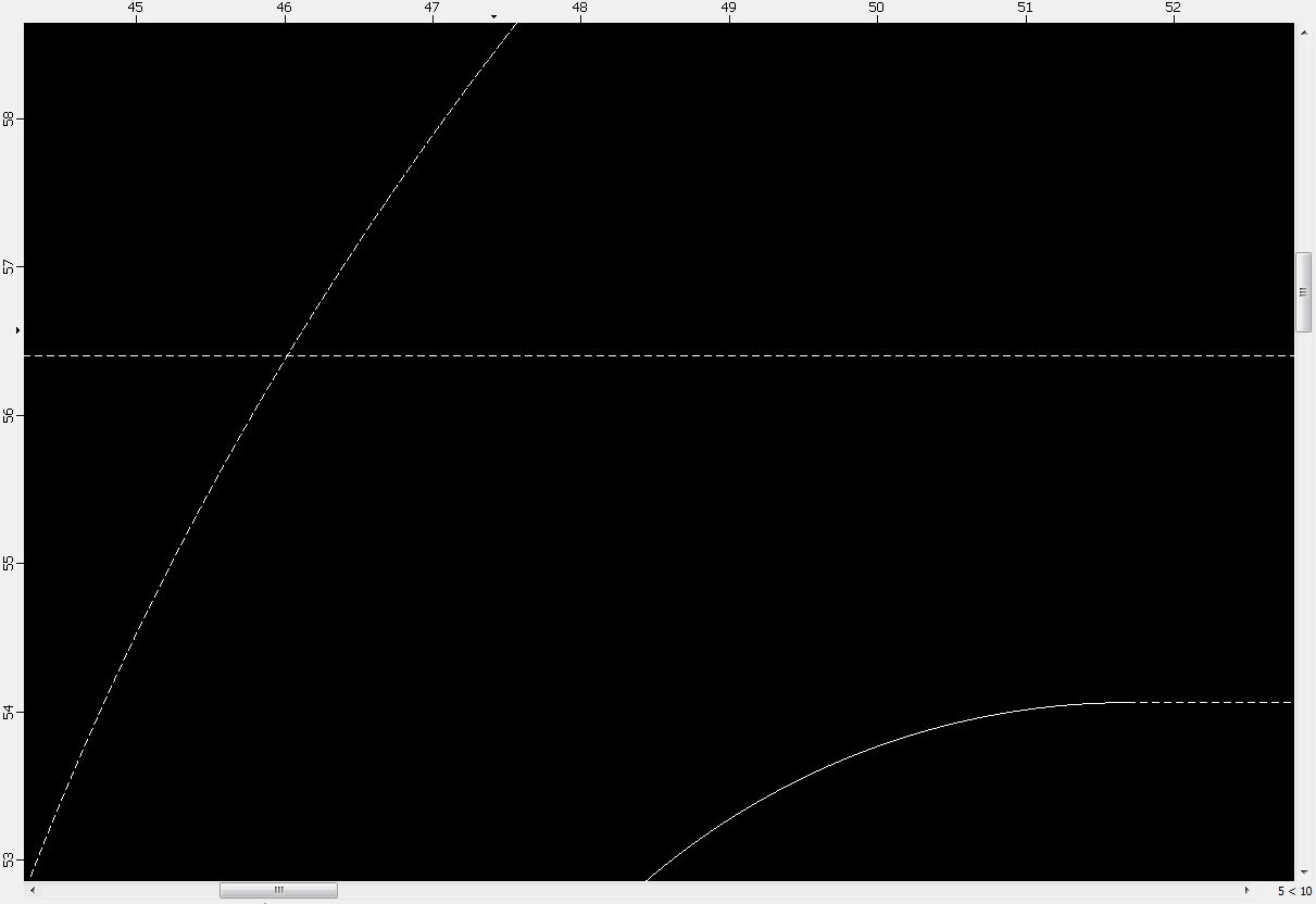

bambuko wrote:
Fri Sep 03, 2021 8:17 am
I have tried zooming in - made no difference
With Husky's file. ScreenBased.
At this zoom state the larger circle looks dashed.
The polyline arc right-low not yet.
There the dashes will reappear when zooming in to about 2x2 units.
For the 1/4 arc in the middle of the drawing dashes will reappear somewhat in between those zoom states.
So it seems radius related ... :?
