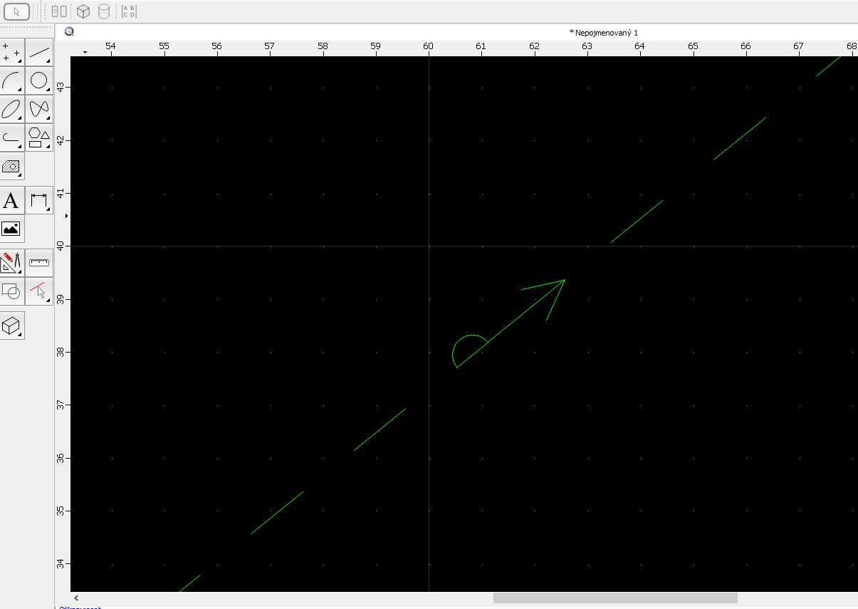

Hi, following a post from Konfi, I have a question about whether the area of the inserted symbol can be filled. For example, so that the arc from the screenshot is not just an outline. Thanks.

I think not, CXF fonts are line art.
One could add a fine hatch or concentric arcs.

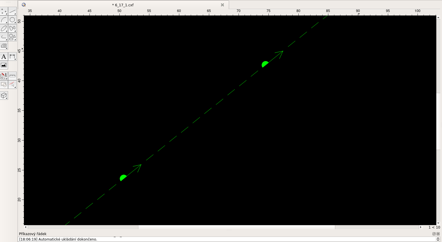

thanks for the advice and for the great product.
Solved.
