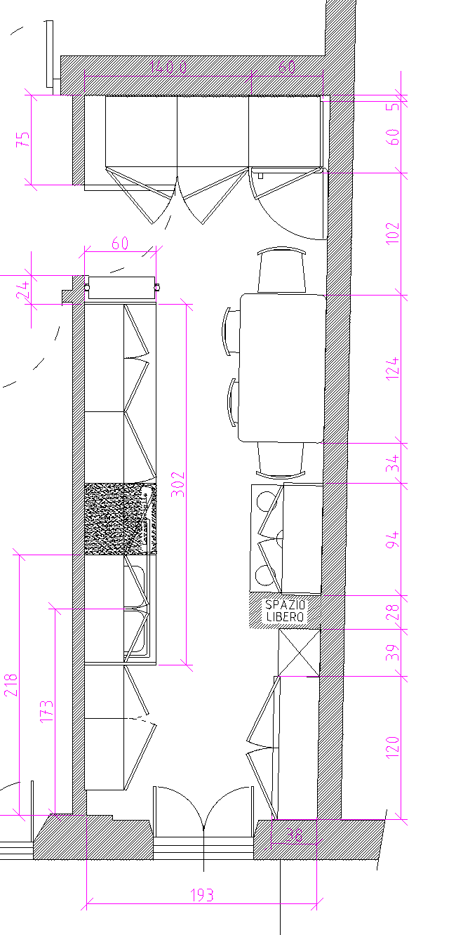

Here is the floor plan of the kitchen, to give you a rough idea of what I mean...
Screenshot 2022-12-20 at 21.44.12.png (102.44 KiB) Viewed 11265 times
Here you can see, along the wall atop, a small misalignment between the refrigerator and its dimension (60).
What happened is that I slightly moved the refrigerator to the left, but the dimensions lines did not move accordingly.
I believe that this kind of problem is inherent in any non-parametric CAD, like QCAD; I understand that there are no ways to prevent similar misalignments between the top view and the relevant elevation view of a wall, other than making a smart use of the copy and stretch functions, as you suggest.
As I understand the drawing you moved the fridge because the door slammed into the wall, correct?
If you know how entities respond to different tools you can easily solve that task with the stretch tool. The Stretch tool will "move" the fridge and adjust the 140 dim. Of course - only one of many solutions ...
