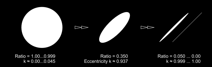

Turns out that the ideal number of intervals is highly exponential ... To start with.
Similar to the eccentricity of an ellipse.
For integrating an ellipse arc from zero to Pi/2 its length, I came up with a rule of thumb that returns rather correct values:
  • Even n intervals = 2 * floor(7.7 / ratio) where the ratio is the minor radius over the major radius.
    A simplified version of the function for a fitted curve on a list of almost ideal numbers of intervals vs ratios.
For a ratio of 0.75 or over the number of intervals would be 20 and as low as 14.
What is fine for the orbit of planets in a solar system for example ... The major field of interest ...
... We tend to draw different kinds of ellipses.
  • Ratio = 0.50 >> 30 intervals.
    Ratio = 0.35 >> 44 intervals.
    Ratio = 0.20 >> 76 intervals.
    Ratio = 0.10 >> 154 intervals.
    Ratio = 0.05 >> 308 intervals.
    Ratio = 0.01 >> 1054 intervals.
    Beyond that the ellipse starts to look more like a line going back and forth.
