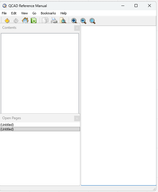

Under the HELP tab, when I select the Reference Manual, there is nothing there.

I cannot reproduce this problem here.
Please try this:
Exit QCAD/CAM and delete the folder:
c:\\Users\[your name]\AppData\Local\QCAD\ReferenceManual
