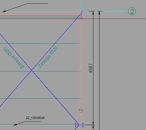

Hello everyone. When I send a DWG to colleagues who open it in other software, I encounter a problem.
The problem is the following - when a drawing is opened in AutoCAD or NanoCAD, dimension arrowheads (Arrowstyle -> Architectural tick) appear with infinite length in AutoCAD.
Drawing in QCAD preview looks like this
A normal arrowhead looks the same in both QCAD and AutoCAD.

I have just installed QCAD 3.32.5 and concluded that Andrew has done some work regarding this issue. Currently, my dimension arrowheads are 5 times larger. The reason for this is that I used a dimension style with an overall factor of 5 for this part of the drawing. The problem is that in AutoCAD, these values cannot be changed, but it is clear that the feature (partially) works for an overall factor of 1.
Best regards
Best regards

Re: Arrowstyle->Architectural tick appear with infinite length in AutoCAD.
The problem is resolved in QCAD qcad-3.32.5.1-pro-linux-qt6-x86_64.flatpak.
Thanks, best regards and happy holidays!
