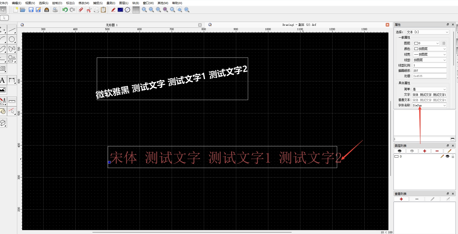

The attachment is the original DXF file, which is displayed in AUTOCAD2020 and displayed in QCAD. Why does the red mark go out of bounds in QCAD? Why does the first line using the Microsoft Yahei font display normally, but the second line using the "SONGTI" font display incorrectly? "SONGTI" is a very commonly used font in Chinese, and the ZIT file is the "SONGTI" font

Not SONGTI but Simsum ... :wink:
Please measure up the height of the first glyph of the bottom text in Simsum with great detail in ACAD.
QCAD reports: 39.545454545454660 with 15-17 significant digits of the floating point double notation.
The last digits not repeating is a sign of a large number of FP operations which are not flawless.
But that won't matter here. :wink:
The bounding box around whole the text is 40.397727272727352 by 716.05391319207126 units long.
First and second Glyph: bbox = 39.715909090909165 by 83.522727272727295 units long
First Glyph: bbox = 39.545454545454660 by 39.886363636363782 units long
Second Glyph: bbox = 39.715909090909165 by 40.056818181818286 units long
Now add a capital 'A' at the end and measure up the height of that.
QCAD reports: 30.00000000... or 30 units exactly.
Font height is per definition the height of the capital 'A' glyph.
Now we have facts and figures that may or may not tell something.

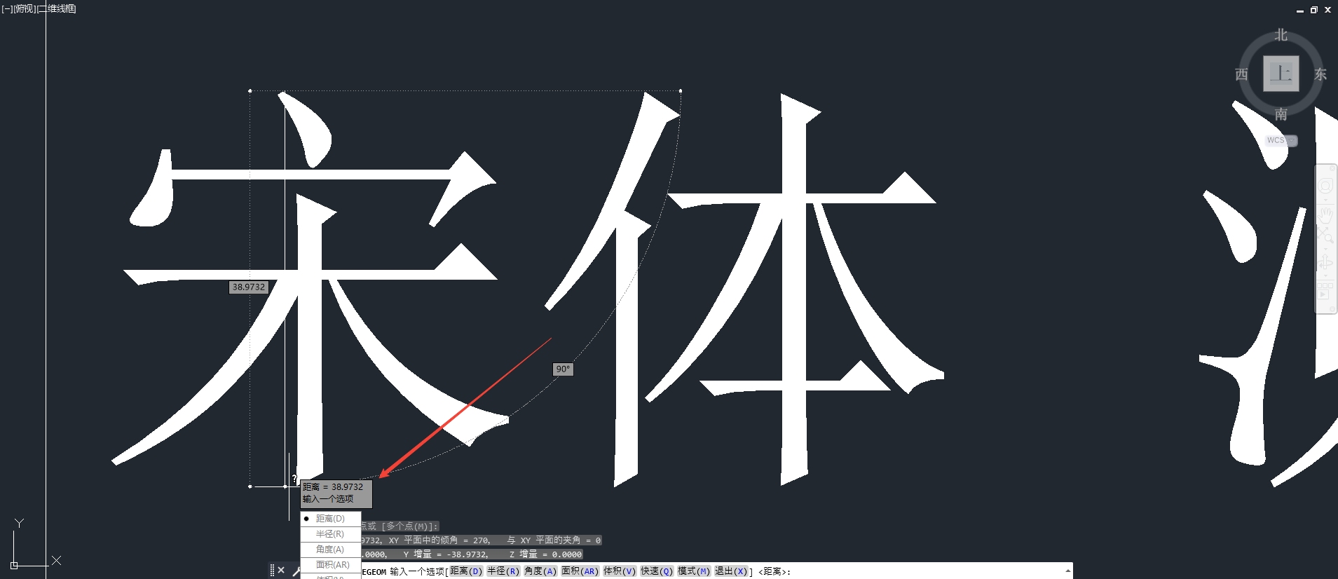

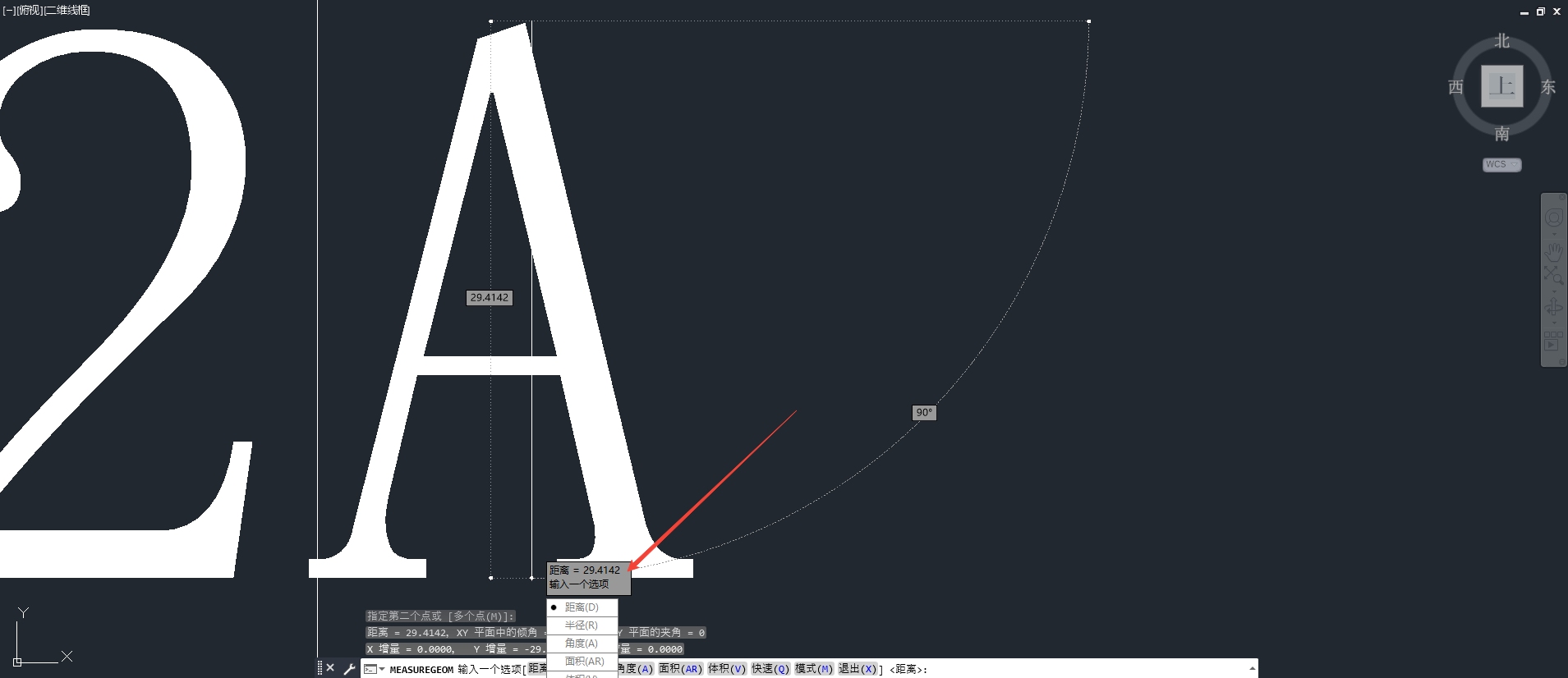

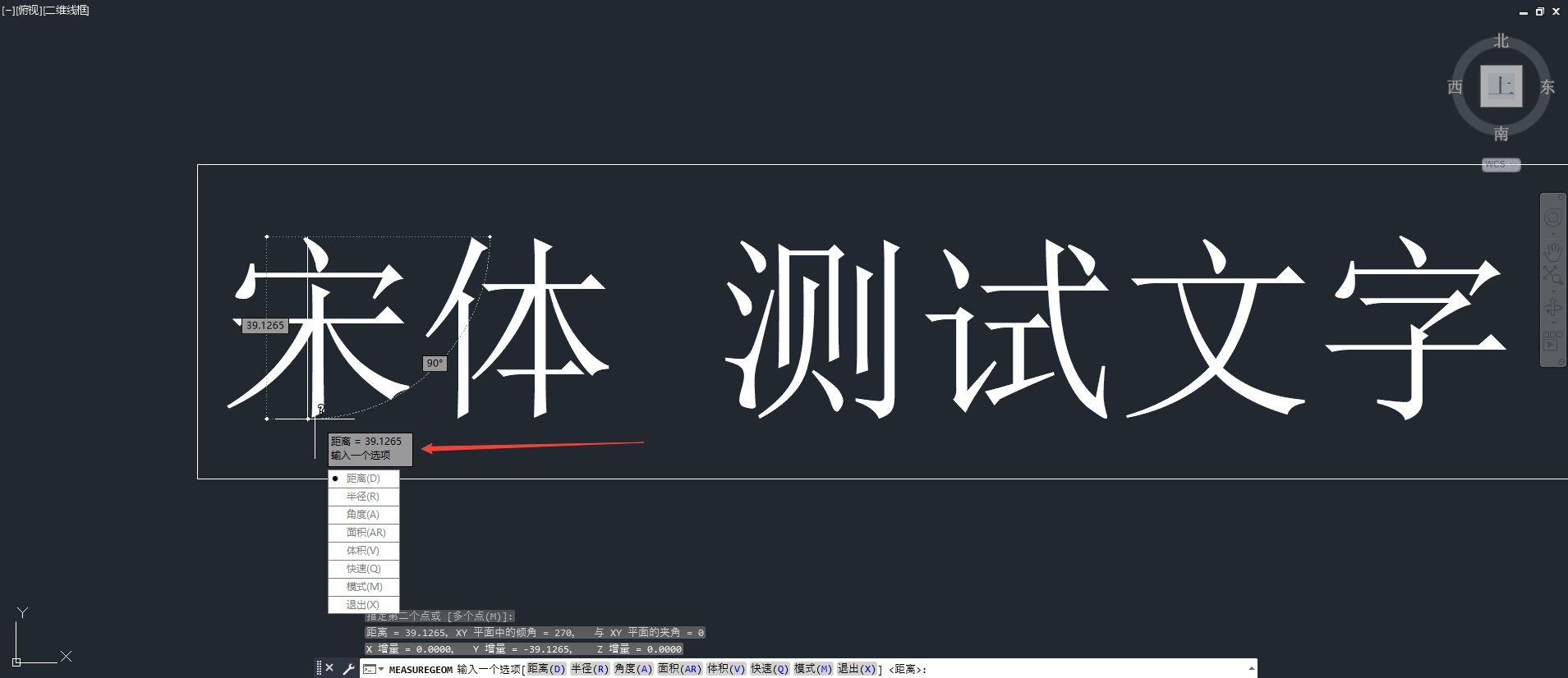

HI CVH
I tested the height of the first text in AUTOCAD 2020 (I don't know if my approach is correct
), the first test height was 38.9732, the second test height was 39.1265, and then added an A, the test height was 29.4142
ACAD breaks with the rule that the Text Height property is the height of the glyph of a capital 'A'.
So sorry, the height is only about 98% (f=0,98047138047 given it is point 414141...)
This scale affects the length of whole the text too :(

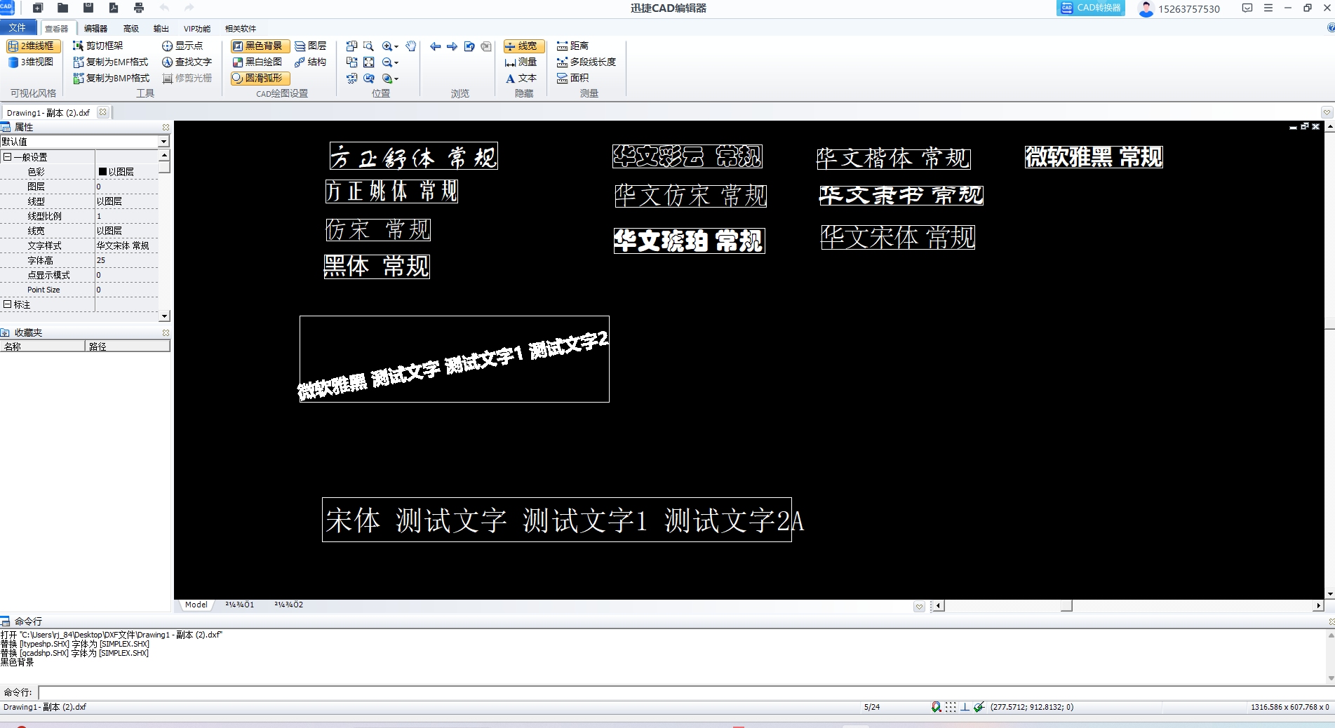

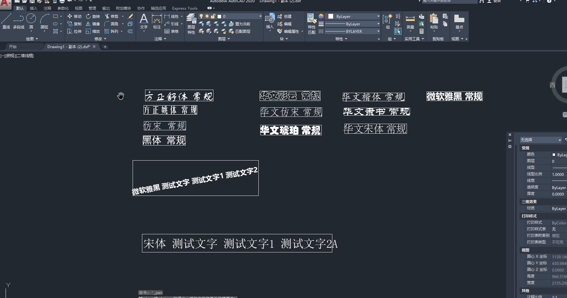

So is this problem a QCAD bug? I tested different fonts using three different software. Two of them were normal. Only QCAD displayed some fonts incorrectly. Can QCAD update a new version to solve this problem? Attached are three software display effects
If the height of the glyph of the capital 'A' matches the Text Height property there is nothing wrong with how QCAD renders text.
I don't think that text rendering under QCAD will be altered.
Just because thousands of people drive through red lights every day doesn't mean we need to change the rules.
For me, simply another user, the cause has been determined, the problem is known and I consider the matter closed.
