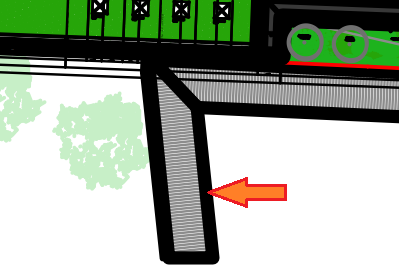

We're having a problem exporting a .dwg file as a PDF.
We've noticed that some of the text and lines are much too thick compared to the original. I've attached the .dwg and .pdf files for you to look at.
Thanks in advance for your help,
Have a nice day!
Alexis

avanhove wrote:
Fri Aug 09, 2024 1:12 pm
That is basically a misconception.
One of the indicated lines has a Lineweight of 0.70mm (ISO).
The PDF format is A4 and printed on A4 this line is just under 1mm wide.
The one at the opposite side are several parallel lines, one has a weight of 0.30mm and the other has a weight of 0.70mm (ISO) ...
... Together they are printed as about 1mm wide.
Meaning that the PDF export is exactly how it was configured. e_geek
Lineweights relate to pen sizes we used back in the days when we drew directly on paper with ink.
0.70mm is always exactly 0.70mm wide on paper, whatever the paper size and/or scale.
Physical pens don't scale.
When displaying your project in Model_Space using Screen-based Linetypes (NL) a pixel based hybrid representation is used.
Not using Screen-based Linetypes then the lines are rendered in their actual size with a minimum of 1 pixel or they would disappear.
And then 0.70mm or even 2.11mm is nothing compared to an overall size of 105000mm.
It starts to play a role when we scale everything down by a factor of about 1300.
Then 0.70mm is about 1% of the overall size.
For the record:
0.70mm scaled down by factor 1300 is 0.00054mm and that would not be printed or it would not be visible on paper. :wink:

Additionally:
There are no such Lineweight limitations for an PDF export with the GUI similar as for dwg2pdf.
The options are then:
- 1) Print/Export all as hairlines.
- 2) Use proper Lineweights.
- 3) A QCAD session wide tweak.
The disadvantage of 1 is that there will be no difference between any of the line-art except for polylines with a width not zero.
Option 2 may be problematic because all the weights in your drawing are defined as a custom Lineweight.
-> In CAD it is common that attributes are governed by the layer: Tutorial: Working with Layers
-> And then Layer states could be used to display things differently depending the usage: Tutorial: Working with Layer States
3) Similar as https://www.qcad.org/rsforum/viewtopic. ... 984#p39984 but then use setMaximumLineweight(double lw)
But there are more unaddressed issues in your drawing.
For example Dimension entities with a Lineweight of 0.13mm and a text height of 0.18mm
The pen size won't be scaled but the text height will be reduced by factor 1300 ...
