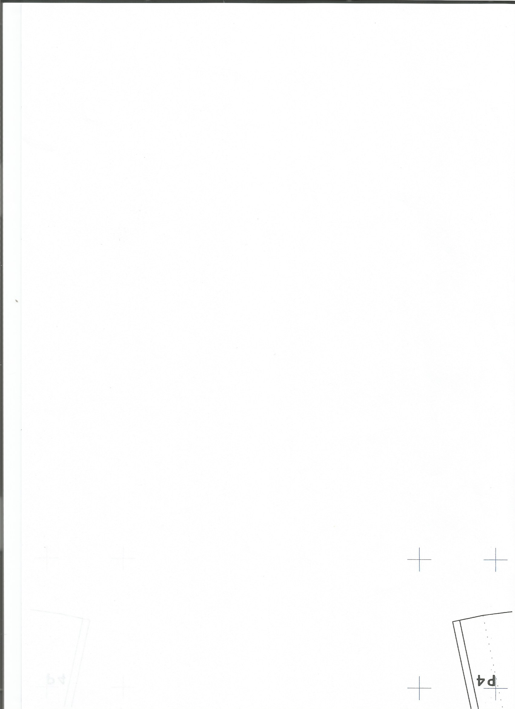

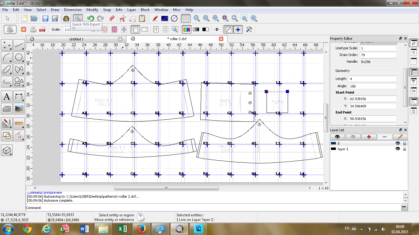

you can see in the screenprint that I have a square that has 4 x 4. My unit measure is Cm. My paper is set A4. The square is to big comparing to A4 paper. And here is a scan of whats happening on paper.
Re: printing issue
Posted: Wed Apr 01, 2015 10:27 pm
by luv_zen_13
That are suposed to be the margins of my A4 paper.
Re: printing issue
Posted: Wed Apr 01, 2015 10:31 pm
by luv_zen_13
I am trying to be as specific as I can. So in the jpg file you have to look down on the page on the right side. the entire white page is an A4 page. And the tiny bit that is printed on down right side of the paper is what was printed. As an A4 page.The scale of the pattern is correct. Is just the layout and size of paper.

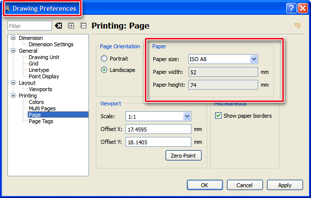

Thank you for the dxf for testing.
Your example drawing:
The Paper Unit is currently set to mm,
The Printing page is currently set to a A8 size what means a total size of the paper is 52x74mm,
To solve the problem adjust the Paper size to ISO A4 (210x297mm) and your 4cm x 4cm Test-square will be printed as a 4cm x 4cm Square. :wink:
