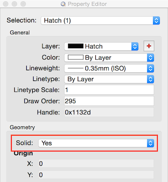

- The rectangle that seems to be solid filled contains really four extremely dense hatch patterns on top of each other (patterns NET and HOUND)
- These hatch patterns cause the large file size since lots of tiny lines are being (correctly) exported to PDF
- Delete three of those hatches and change the last one to solid:
Screen Shot 2015-06-03 at 10.37.30.png (60.95 KiB) Viewed 19854 times
- Export to PDF -> file size will be about 150kB
