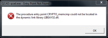

From a QCAD user:
QCAD on Windows 64bit shows the following error:
The procedure entry point CRYPTO_memcmp could not be located in the dynamic link library LIBEAY32.dll.

It looks like QCAD (or rather the Qt library QCAD is based on) is trying to access and use a broken OpenSSL installation on your system.
You can download prebuilt packages of OpenSSL for Windows from http://slproweb.com/products/Win32OpenSSL.html
If you are on a 64bit Windows system, you might want to install the 64bit version of OpenSSL.

Hi, I have this same problem, and have tried to install openssl which wasn't even installed on my system to begin with, but alas made no difference, so remove it. I did do a search for LIBEAY32.dll on my system and returned many different versions - seems to be package dependent, but none showing for Qcad. I can only quess Qcad is referencing a LIBEAY32.dll file in another package installed that doesn't have the required function - hence the error message ? Is there anyway I can find out which LIBEAY32.dll is been referenced ? Thanks for your help.

Right good news - TEMPORARY installed the 64bit version of openSSL copied the libeay32.dll file from the openSSL directory into the Qcad 64 bit programfiles folder, then uninstalled the 64bit of openSLL... restarted Qcad and problem has gone away :-) But to re-emphasis without this specific .dll been referenced for library function calls latest version of Qcad wouldn't work properly. Referring to Qcad 64bit Pro version. Hope this helps someone else get Qcad pro working again. Thanks Andrew again for your help.
