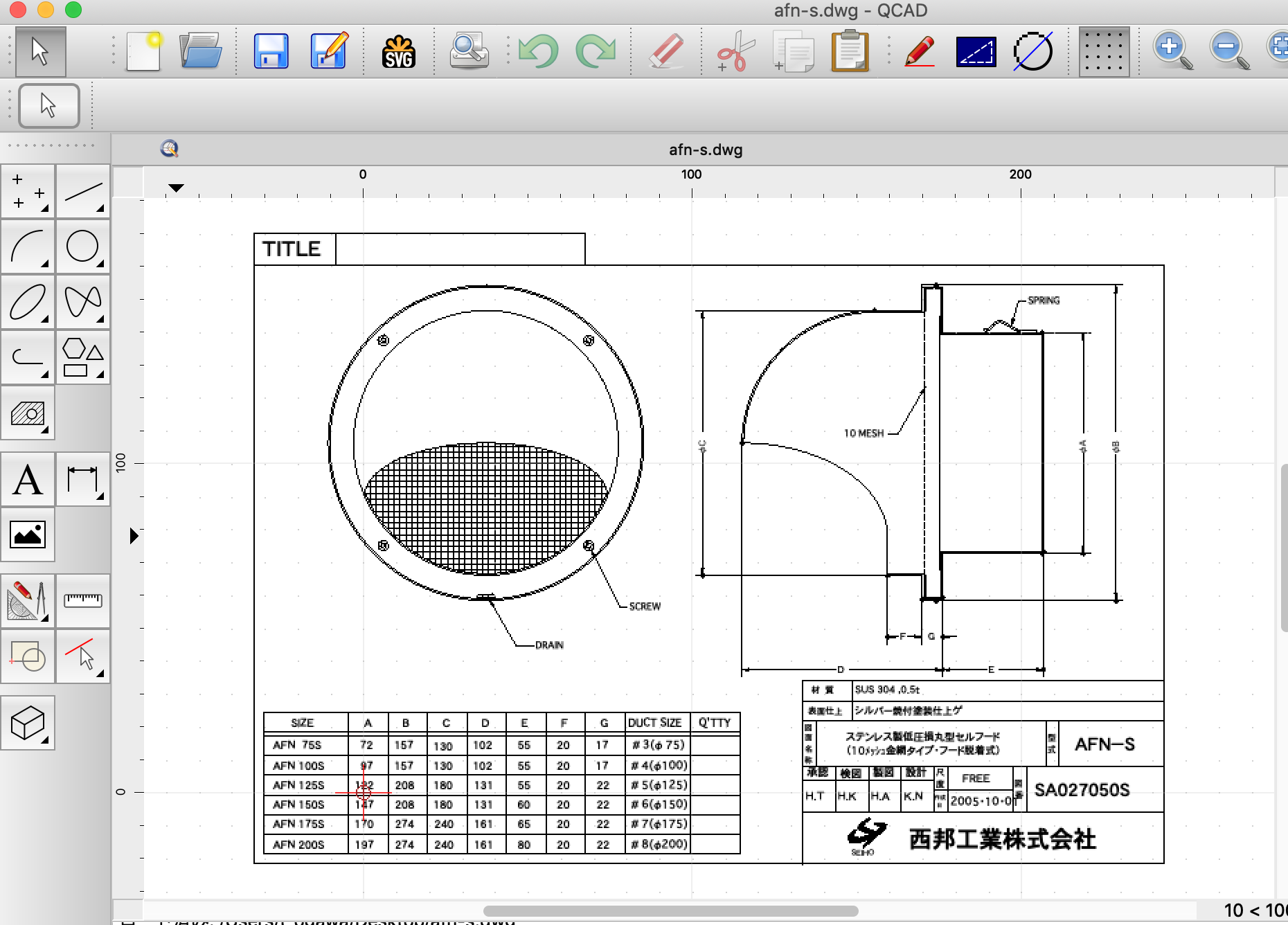

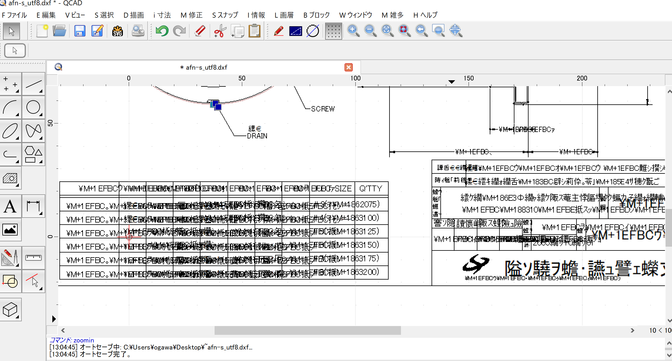

It is garbled when reading DXF file including Japanese / full-width characters with QCAD for Mac / Linux version.
In the Windows version, the character is not garbled if it is SJIS, but in the Mac / Linux version, garble occurs in both SJIS / UTF8.
However, even in the Mac / Linux version, Japanese is displayed for DWG files converted by AutoCAD.
Is the Mac / Linux version not compatible with DXF including Japanese / full-width characters?
Thank you.

It is additional info.
①
DWG(afn-s.dwg) → In → QCAD(Mac) → Out → DXF → In → QCAD(Mac) - Not garbled
②
DXF(QCAD Output) → In → AutoCad(Mac) → Out → DXF(AC R2004 / AC R2018) → In → QCAD(Mac) - Not garbled
③
DXF(afn-s_SJIS.dxf) → In → AutoCad(Mac) → Out → DXF(AC R2004 / AC R2018) → In → QCAD(Mac) - Not garbled
Is this a problem with the DXF file?
①
②
③

Re: [Mac/Linux] Japanese / Full-width Garbled
Yes, there is a problem with this DXF file: it does not provide a code page (encoding).
You can open the DXF file in a text editor and add the code page to it as follows:
Beginning of file (original, without code page):
Beginning of file (new, with code page):
This will fix the issue with text encoding. Note that the font "standard" in QCAD does not contain any Japanese glyphs, so you will also have to substitute the font with another font, for example Arial (Edit > Substitute Fonts).
For more details about this issue, please refer to the Autodesk website.

Hi Andrew.
Thank you for reply.
I tried, the problem was solved.
Thank you!
