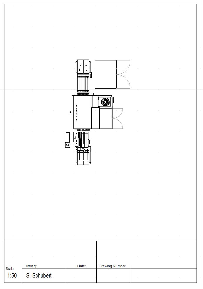

				Here is a sample:
Export with Microsoft PDF writer via print dialogue (same result as a real printout)

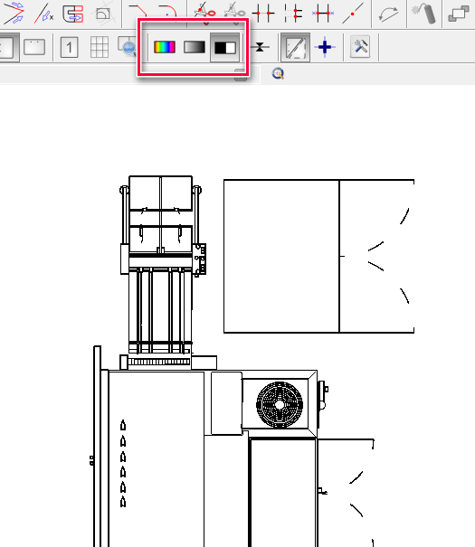

Edit: Ok, I see. I didn't test it with the Microsoft PDF writer.
Howsoever: What is your print color mode? Full Color Mode or Black / White Mode?
						- Husky-2020.01.21-03.png (22.88 KiB) Viewed 11044 times
