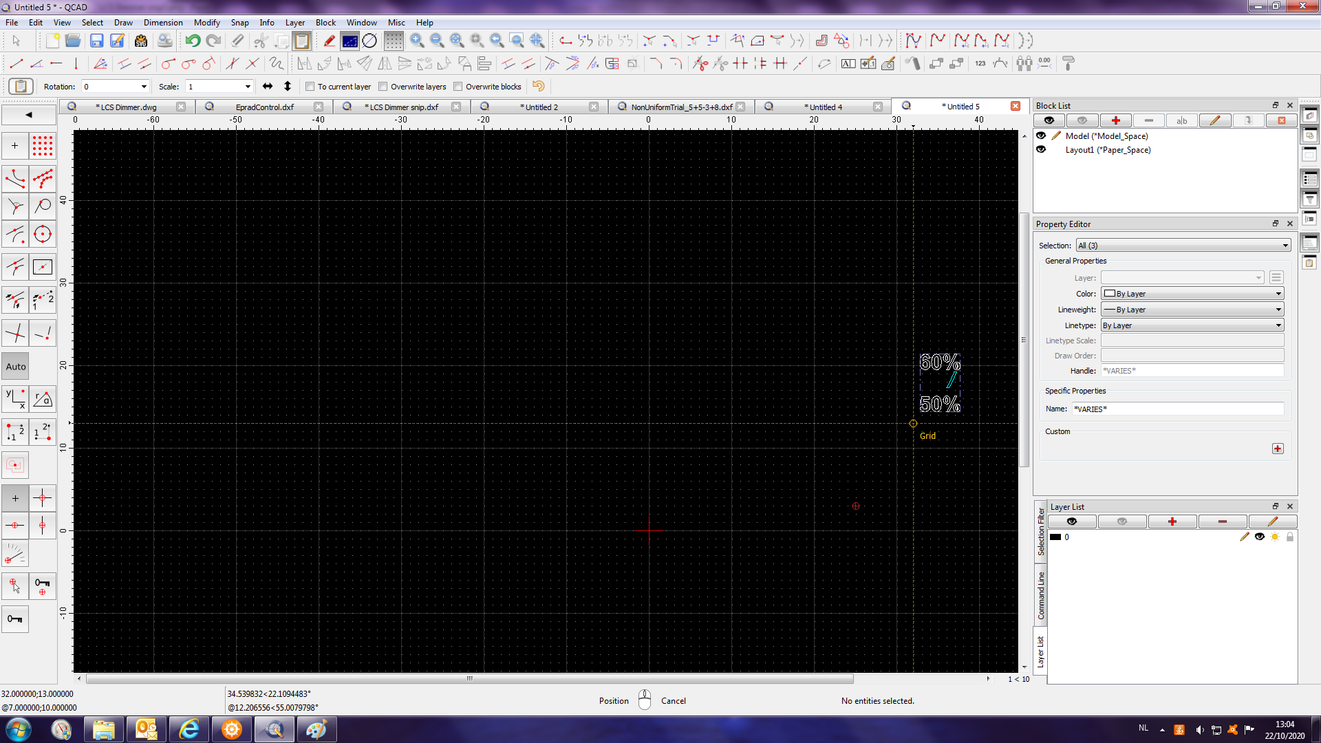

No pasted entities are showing.
No extra layer is showing.
One can see the last RZ.
The preview is still hanging on the cursor.
LCS Dimmer snip1.png (252.33 KiB) Viewed 5178 times

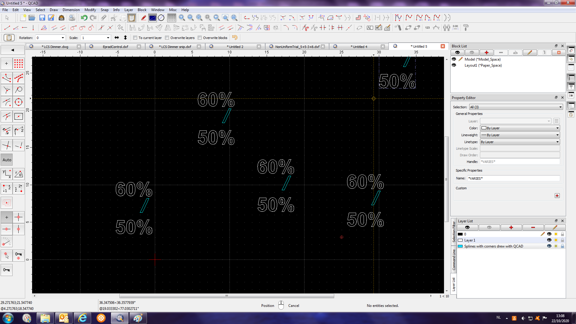

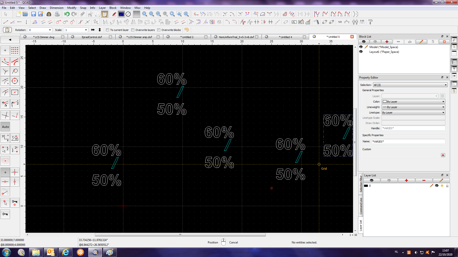

When I zoom a little with the mousewheel, the entities appear.
LCS Dimmer snip2.png (258.19 KiB) Viewed 5178 times
When I switch to the drawing 'Untitled 4' and switch back, the layer list is updated.
LCS Dimmer snip3.png (261.42 KiB) Viewed 5178 times

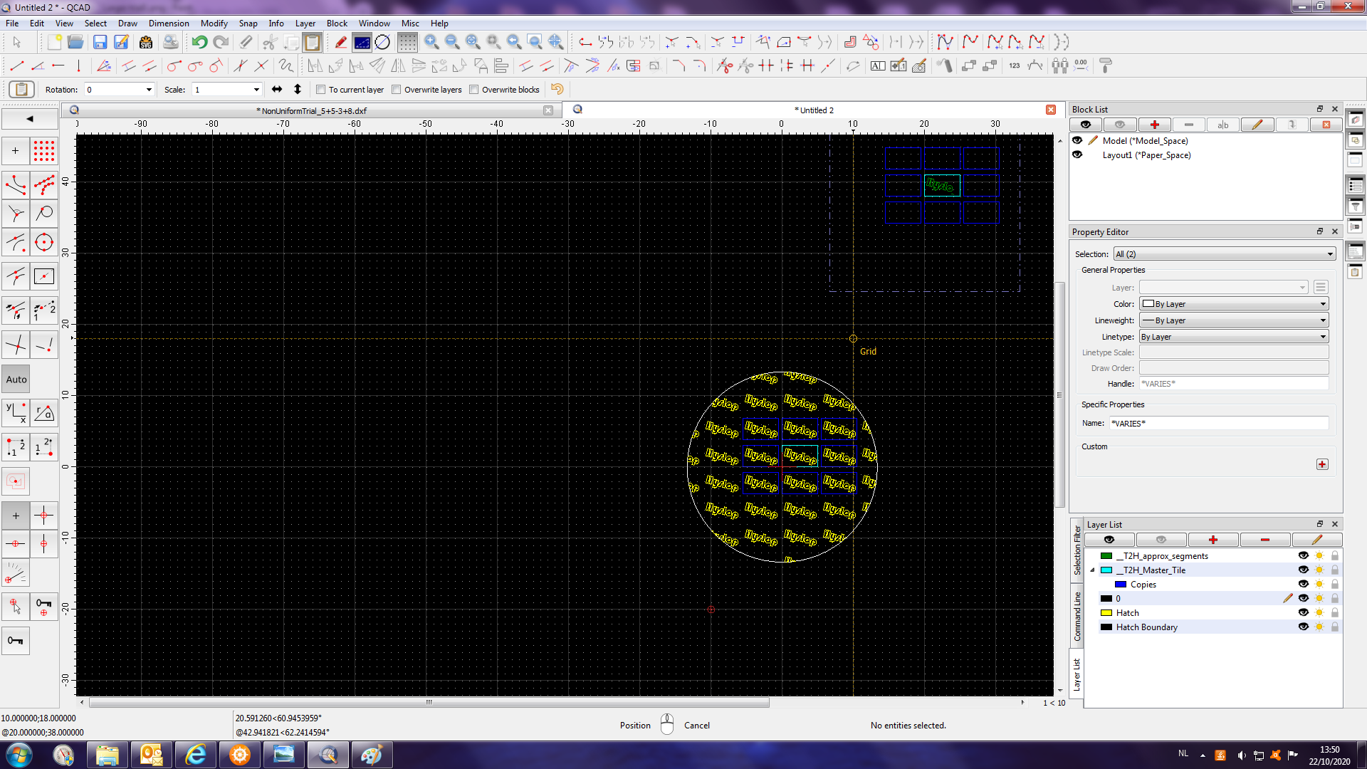

After pasting:
Clean trial1.png (289.78 KiB) Viewed 5174 times
After swapping document views:
One still can see the preview hanging at the cursor
Clean trial2.png (274.32 KiB) Viewed 5174 times
And yes, the yellow entity is a hatch by T2H. :P
Don't say that I need another full system wipe ....
