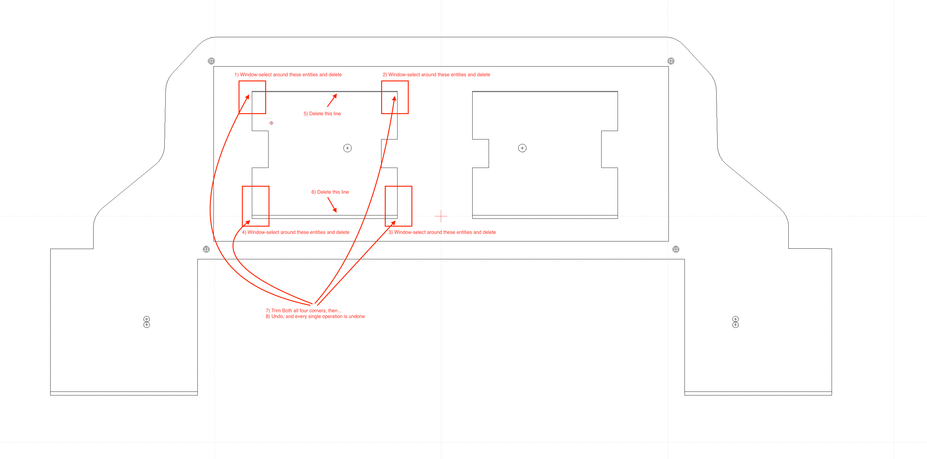

I just updated to 3.26 on macOS, and while I don't recall seeing this bug after using Trim Both (TM) in 3.25, I am certainly running into it now. The undo stack is either getting corrupted or multiple operations are getting coalesced into one undo operation by Trim Both. Needless to say, this wreaks havoc on the file if I make a number of edits and them Trim Both, then undo after that... Many edits get lost.
I've attached a quick set of instruction and a file to reproduce it. The file is a 2D export from a 3D app, and it's littered with small line segments that need to be cleaned up, which a typical daily operation for me.
Thanks,
Brock
Screen Shot 2021-03-03 at 5.58.19 PM.png (161.69 KiB) Viewed 15342 times
dash2.dxf
(219.09 KiB) Downloaded 1266 times
Can't reproduce that behavior on a Win10 OS. All Undoes are working step by step as expected ...

Thanks Husky. I needed that confirmation as a reality check, and I think I've managed to find the culprit when reproducing it again on my side...
I've been working on a script for converting segmented arcs to true arcs, and one of the things that I've been grappling with is a lack of details on operations and transaction stacks... I believe that my script leaves a transaction group open, and I'm seeing the effect when performing subsequent operations and undoing them. The odd thing is, I closed this very doc and reopened it, and the problem persisted so I assumed it wasn't related to my script. And even more oddly, not every subsequent operation is undone all at once... Some undo properly one-at-a-time, and then some undo all-at-once.
Anyway, thanks for checking.
