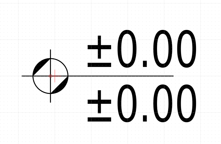

Ah, ok. Doesn't matter. The pline arc has half the radius as the outer circle. So it has a width of 2R to fill exactly a quarter of the circle. Too bad it doesn't work in my load.
Screenshot from 2020-12-19 11-07-00.png (28.73 KiB) Viewed 13176 times
If i fiddle a bit with the width it does work.
Thu Dec 17, 2020 6:04 pm
With Width = Rarc QCAD swaps from sector to segment.
Aha, but how can it take the segment of the outer circle? More testing shows me that width flips to a segment when the arc is smaller then half of a circle. Must be some unwanted behaviour. :!:
A box around the entities doesn't select anything here.
Nor where the reference would reside.
It works for me if I box around the entities and the reference (in one box).
So after exploding the segments are this huge e_surprised
Screenshot from 2020-12-19 11-15-48.png (39.53 KiB) Viewed 13176 times
And setting the Z-values to zero fixes this.

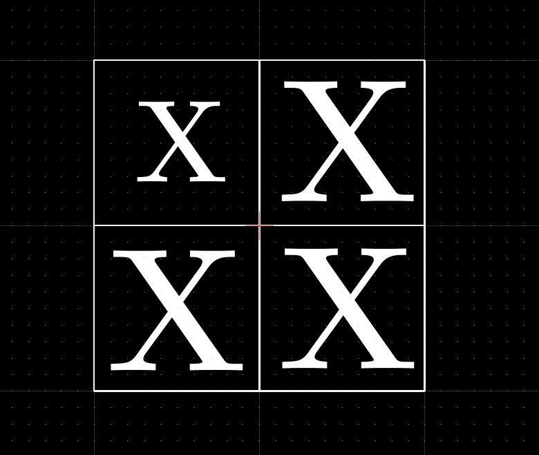

Attributes are disappearing after synchronization? Is this user error?
I define a block, and 4 attributes

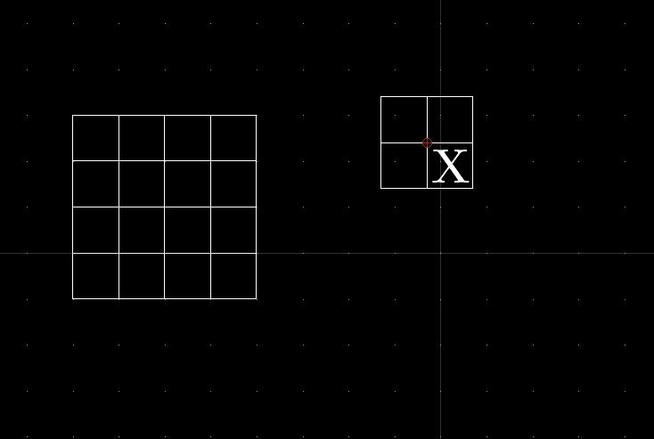

Block Definition 1.JPG (115 KiB) Viewed 12490 times
Insert the block into the main drawing, everything is fine.
Block Insert.JPG (24.34 KiB) Viewed 12490 times
Then edit attribute property in the block definition - text size
Block Adjustment.JPG (53.48 KiB) Viewed 12490 times
Return to main drawing - Synchronize - and 3 out of the 4 attributes disappear from the inserted block?
Block - Post Syncronize.JPG (23.39 KiB) Viewed 12490 times
