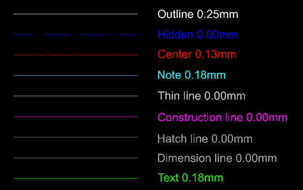

In my opinion CAD layer standards should at least cover the following:
1. Drawing units.
2. Scale - drawings in model space at 1:1 (full size). Finished drawings should be scaled in print preview (paper space) / Viewports.
3. Layer - colour, all colours ( White, Black, Red etc.) should be BY LAYER.
4. Layer - line weight, all line weights (0.25mm, 0.5mm, 1mm etc.) should be BY LAYER.
5. Layer - line types, all line types (continuous, dashed, center etc.).
6. Dimension styles, Text height, Arrow style, Format -Decimal, scientific etc...
7. Text style, font style, font height etc.
There are many, many more that I could mention but the above should suffice for most drawing standards.

For me personally I base my CAD drawing standards on AEC (UK) CAD standards. With similarities to the ISO and BS-1192 standards.
I have attached a dxf file with my AEC (UK) CAD standards for use - see here in 'Tips & Tutorials'
layer standards.png (33.43 KiB) Viewed 259649 times
