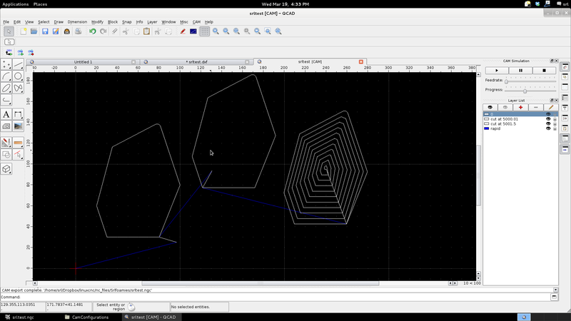

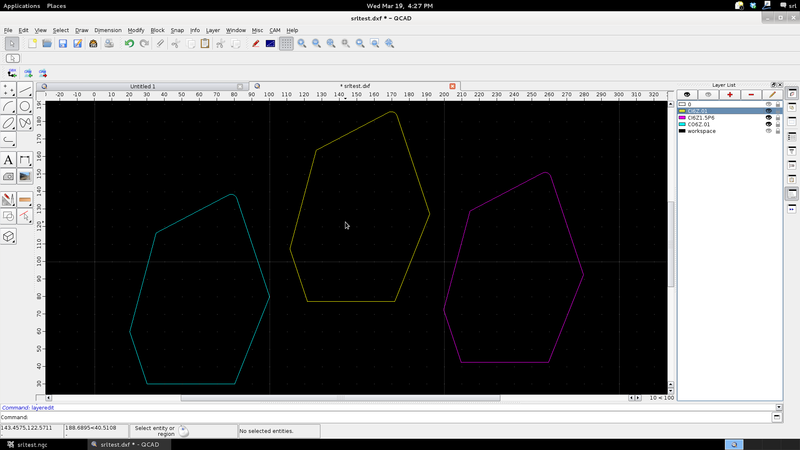

At last here is some real testing with the above file.
The three shapes are all the same. The first has 'CO6' (cut outer 6mm) in the layer name. The second 'CI6' (inner). The third has CI with P6 for pocket. The Z levels are also set. You can get the dxf file at the end of this post. You must set the direction in the CAM dialog, in this case clock wise. Here is the generated path.

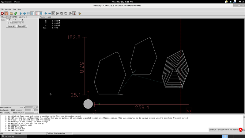

The LinuxCNC sim.

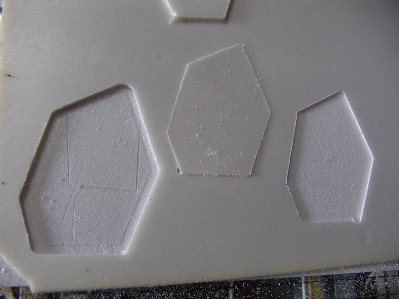

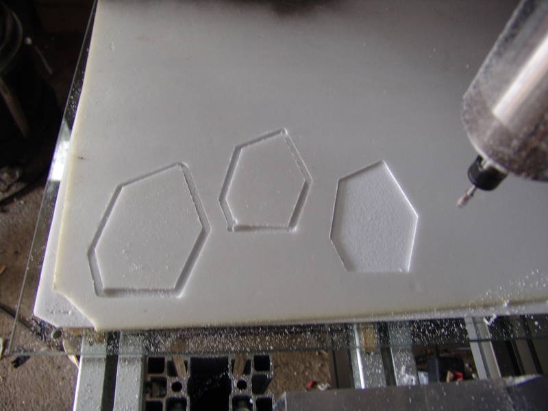

Here you can see the G41 and G42 path as it is all in the same direction. In my latest file you can set the direction of closed contours by putting CW or CCW in the layer name or custom properties. The real thing after a quick vacuum.

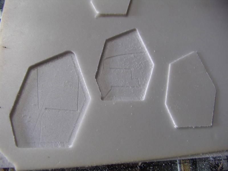

The first part cut out fits into the second cut. It over ran at the end as I didn't set the Ramp Off.
It also fits the third, but not all the way of course as it was milled to half its thickness 1.5mm.
