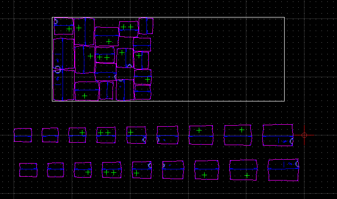

I have upgraded from pro to cam to use the nesting function. However, it does not work as expected. If I set rotations to 4, all parts are nested. However, as soon as I set rotations to 1 as required, only one part is inserted. What am I doing wrong?

Can you please try with the following default preferences:
Weighing of primary alignment (Gewichtung der Primärausrichtung): 2.0
Hull resolution for blocks (Hüllenauflösung für Blöcke): 20

Can you try enabling another default: Place small parts into holes of other parts (Kleinteile in den Aussparungen anderer Teile anordnen)

For whatever reason, it helped e_surprised
At least on my windows computer, I'll check it under linux tonight.

Bug report at:
https://www.qcad.org/bugtracker/index.p ... sk_id=2526
This has been fixed for the next release.

QCAD/CAM 3.29.4 is now available which should fix this issue.
