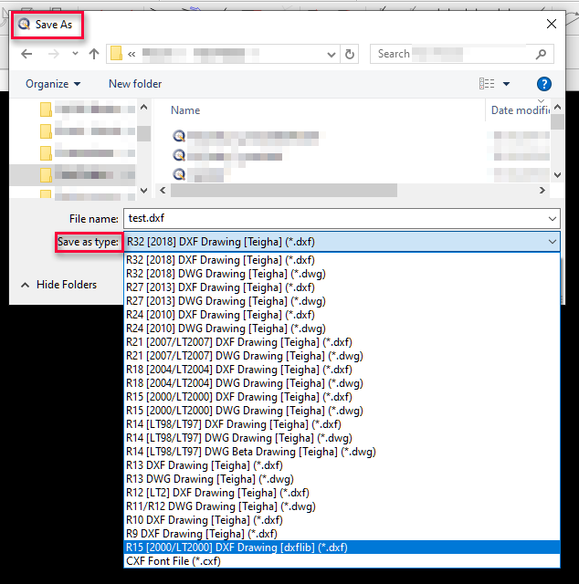

Properly there is a reason not to offer anymore a 20 year old version .... :wink:
Howsoever - you are still able to save a drawing in an old version (even R15) within the "Save As" dialog ...
... and for obvious reasons I do not recommend to edit the config file manually.

Version 2000 DXF is the only version that prints from autocad layer 0 set to white as default..this is the only reason I've set it as default..I know you can save as ver 2000 but if I forget it doesn't print... don't get me wrong here I think qcad is a brilliant program.. I've used autocad for over 30 years and now switched over to qcad professional version...I only use for 2d for 3d I use Autodesk Inventor...As for the configuration file if for some reason you happen to make a mistake you can simply delete it and qcad will create a new one on next startup...all you need to do then is setup all your preferred settings again..
