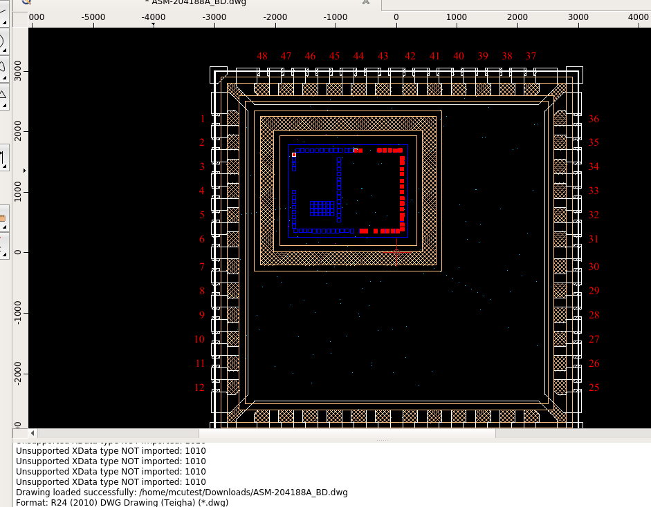

When I open DWG files in QCAD, I see many error messages like these:
Unsupported XData type NOT imported: 1010
Unsupported XData type NOT imported: 1011
Sometimes the lines in the drawing are not fully drawn in or have the wrong weight as compared with other tools.

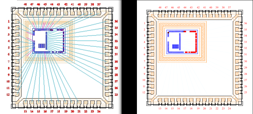

Included are screenshots and conversion comparison between ACME CAD Converter and QCAD.

skatea2015 wrote:When I open DWG files in QCAD, I see many error messages like these:
QCAD does not support all types of available XData (additional, typically non-standard data attached to objects). In most cases, you can simply ignore those messages.
skatea2015 wrote:Sometimes the lines in the drawing are not fully drawn in or have the wrong weight as compared with other tools.
If you are referring to those blue lines at various angles, these are polylines with a custom lineweight set to 0.23 drawing units. Since the whole drawing is about 7000 drawing units wide, 0.23 drawing units is indeed extremely thin (barely visible or not visible at all in a bitmap / on screen).
Perhaps adding a minimum line weight command line switch would serve you best? Can you confirm this?

Ok, I see what you are saying about the polyline thickness...they are very thin relative to the size of the drawing.
My guess is that ACME CAD Converter has some minimum line thickness that it will use instead, which is why we do not have a problem there.
It would be very helpful to have the capability to set a minimum polyline width in QCAD.
