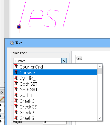

using Windows 10 and QCAD 3.23.0
Help me understand. The font selection looks like it should be True type as designated by the "TT" at the left of the font listing.
However it does not appear on my windows/font folder, but it does appear on my program files/qcad/fonts/cursive.cxf
using dxf version

1. Is there a way to restrict font selection in QCAD to ONLY True type. At least identify truetype or shx or cxf?
2. Is there a way to identify that a font is a cxf. for instance textstyle1 in this dxf is listed as ltypeshp.shx. couldn't the cursive font be saved as cursive.cxf ?

Re: font listing and export
These are CXF fonts.
https://qcad.org/rsforum/viewtopic.php?&t=4899
...and others
QT can't make the difference.
And displays them as TTF.
...and others

- Posts: 8791
Yes, under Edit > Application Preferences > Draw > Text > Use reduced selection of fonts:
You can find a list of all CXF fonts (the ones to disable) under fonts in your QCAD installation directory. CXF fonts are also listed at the top of the font list in alphabetical order. TTF fonts are listed below CXF fonts.
No, that would not be DXF standard conform. DXF uses shx files. QCAD does not support the .shx font format. Other CAD don't support .cxf.

Thanks for the suggestion to untick the first entries on the reduced selection of fonts. That should have occurred to me. I would still like to see what type of fonts they are though, cxf or TTF
