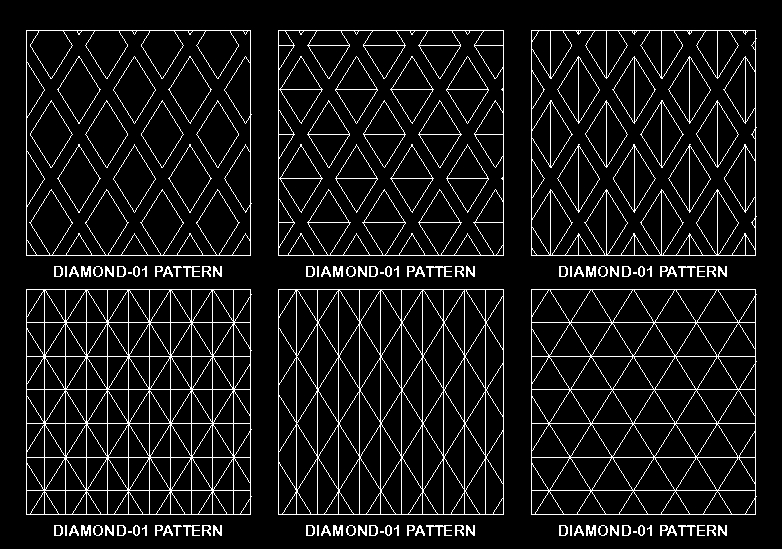

Hi All
New Pattern Added Diamond-01 & Updates to Triangle-01
11 Adjustable Patterns to Date :wink:

Hi All
Just to let you know, all these patterns can be altered to produce different results
simply by playing around with the settings for instance below, just swapping 2 settings
Height & Width produces a completely different pattern....
Pattern is also stable at 1000,000 Units not Tiles as previously posted from datum...
Diamond Settings.jpg (61.02 KiB) Viewed 1769252 times

Caused by a Dimensioning error by me :oops:
I also spelled Horizontal wrong in Diamond-01 & Triangle-01, it's been spelled incorrectly since version 2.8 :oops:
Weave Flaw.png (8.14 KiB) Viewed 1765717 times
