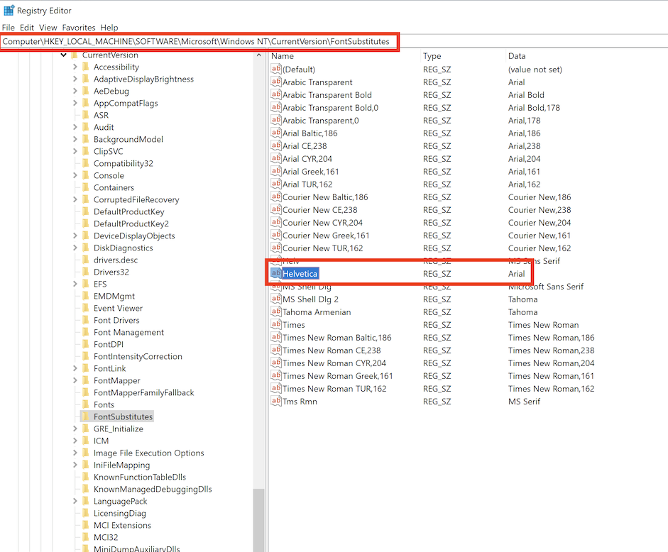

I did some quick digging and I'm not sure if this is a Qt bug (the library QCAD uses for text rendering among other things) or a Windows "Feature" or a mixture of the two.
In a nutshell, Windows really likes to substitute Helvetica for Arial. There's a registry entry that controls that behaviour, under Computer\HKEY_LOCAL_MACHINE\SOFTWARE\Microsoft\Windows NT\CurrentVersion\FontSubstitutes:
If you change that to "Helvetica" with value also "Helvetica", the effect in QCAD is instantly visible.

Yup! That definitely fixes the problem. Thanks!
