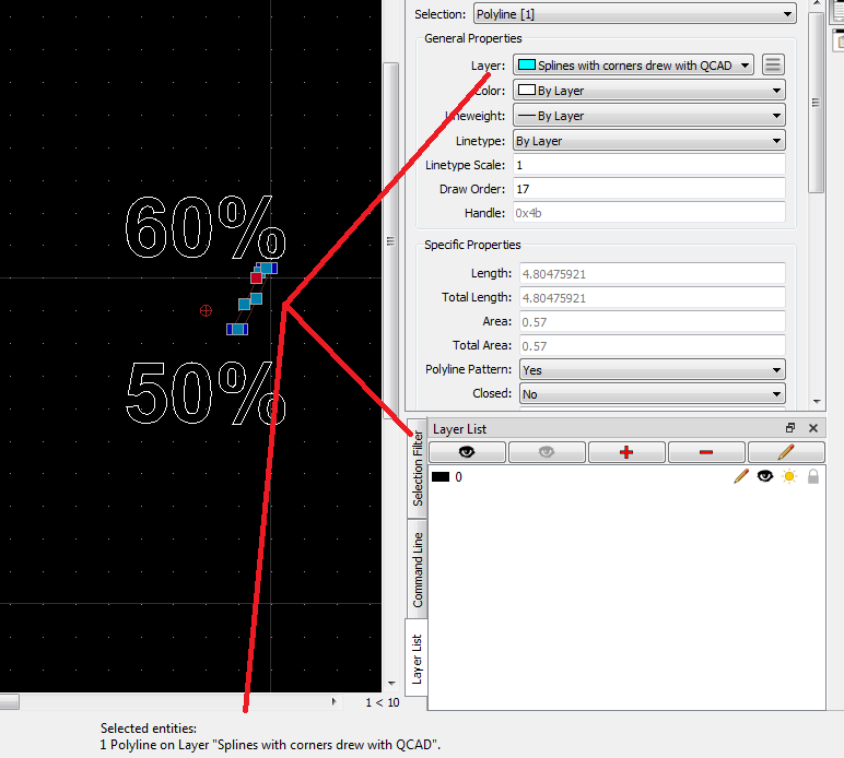

I drew a spline with hard angles in the dwg file.
Copied a snip to a new file and the newly added layers were NOT displayed.
After saving and restoring, the drawing looks good.
See the posted file: LCS Dimmer snip.dxf
I have redone this several times.
Eliminated the nature of the splines by converting them to polylines.
What I found was:
A: The paste does not show the pasted entities immediately.
Even not pasting 5 times, only the preview you drag along does, they all appear on the first pan / zoom.
B: the addition of layer List does not change immediately, they appear on the first refresh of the layer list by:
- add/edit/change layer
- swapping drawing views
- after save/revert (also a refresh offcource)
LCS Dimmer snip.png (39.31 KiB) Viewed 5182 times

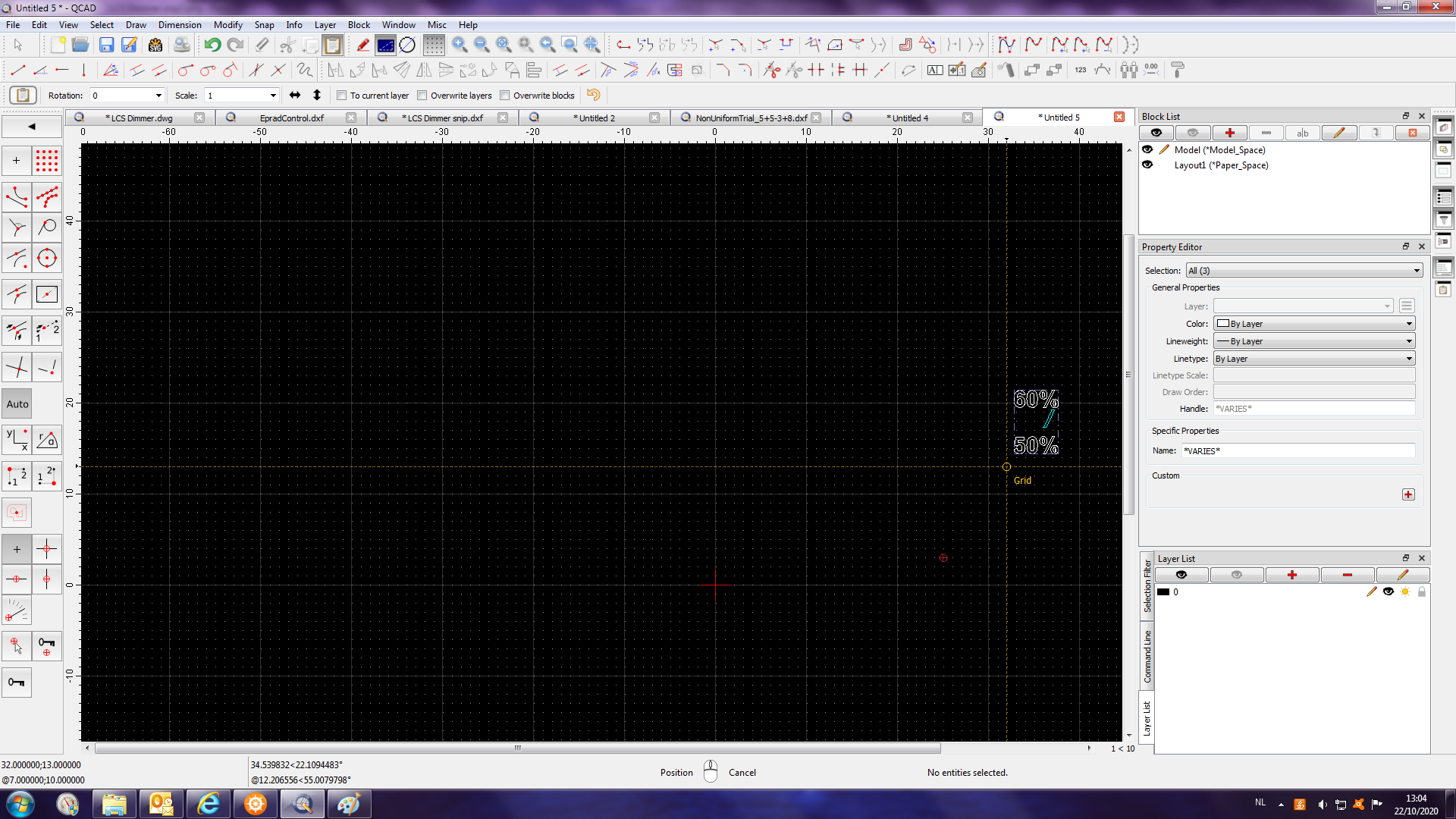

I proceded as follows:
- loaded the file "LCS Dimmer snip.dxf"
- box select all
- copy (the same with refs)
- paste into a new, empty document
Pasted it 4 times (using default paste options, see top)
No pasted entities are showing.
No extra layer is showing.
One can see the last RZ.
The preview is still hanging on the cursor.

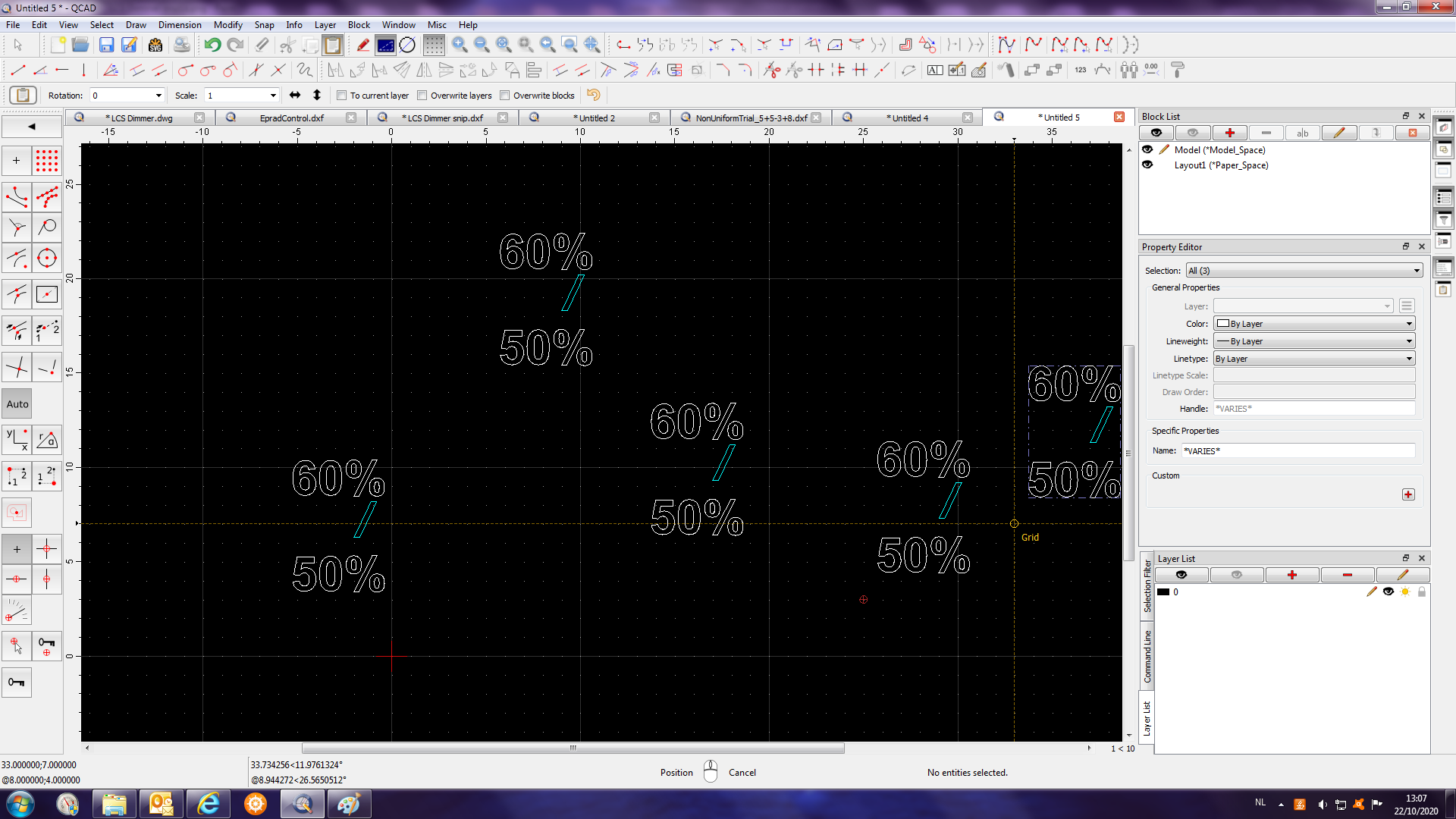

When I zoom a little with the mousewheel, the entities appear.
LCS Dimmer snip2.png (258.19 KiB) Viewed 5176 times

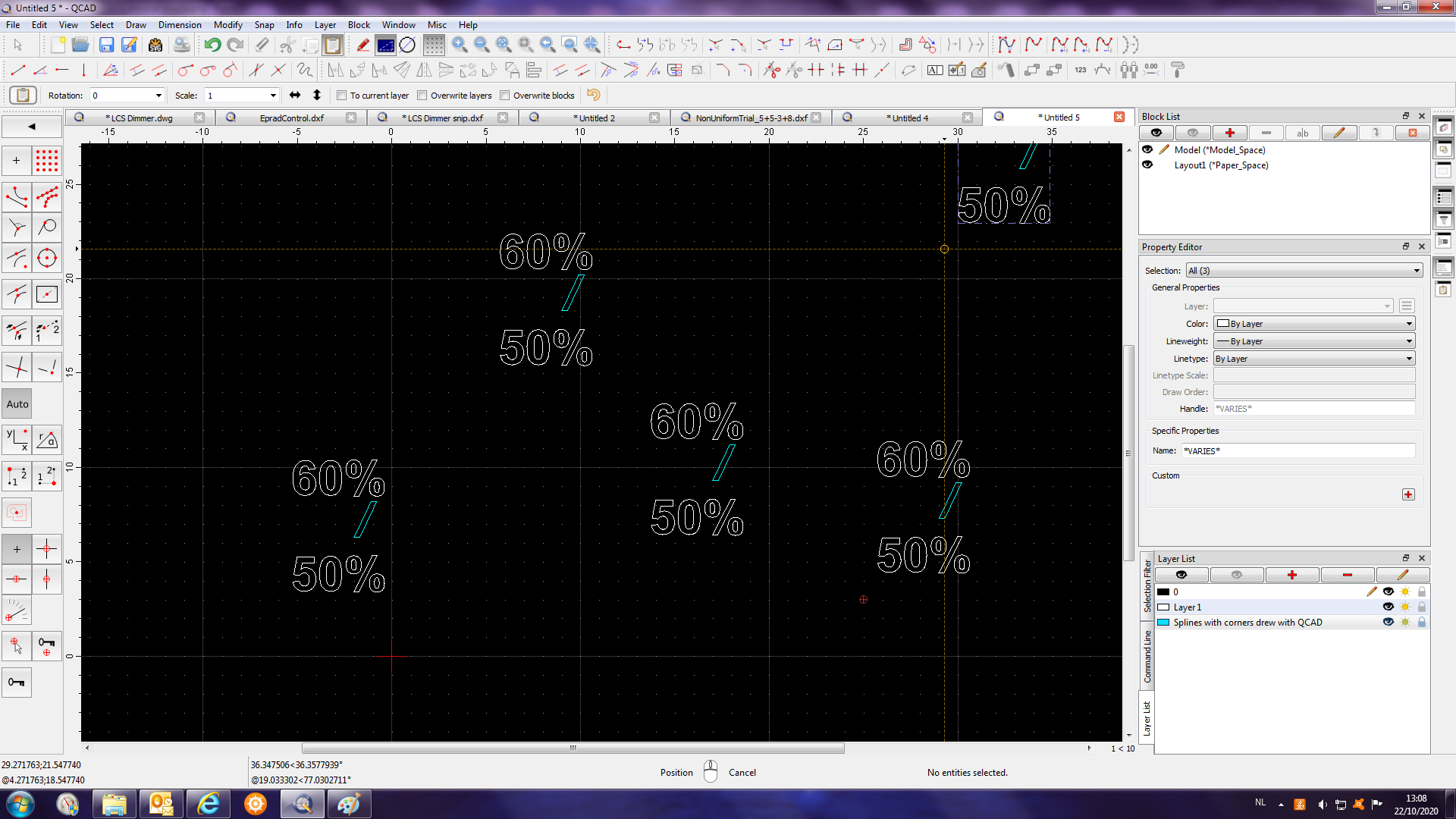

When I switch to the drawing 'Untitled 4' and switch back, the layer list is updated.
LCS Dimmer snip3.png (261.42 KiB) Viewed 5176 times
I can reproduce this with every source.
I can reproduce this with a single selection too.

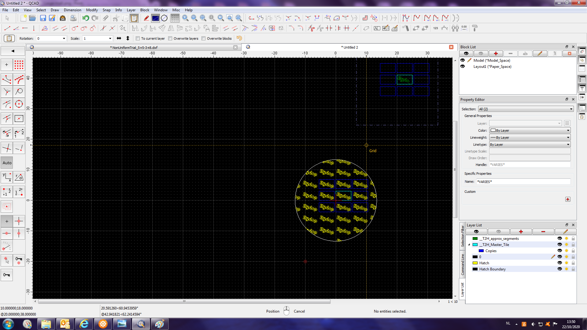

Post by CVH » Thu Oct 22, 2020 2:02 pm
The only difference with a standard installation is the development of Tile2Hatch.
I removed it completely, including its settings in the QCAD3.ini ...
Same result :cry:
After pasting:
Clean trial1.png (289.78 KiB) Viewed 5172 times
After swapping document views:
One still can see the preview hanging at the cursor
Clean trial2.png (274.32 KiB) Viewed 5172 times
And yes, the yellow entity is a hatch by T2H. :P
Don't say that I need another full system wipe ....
