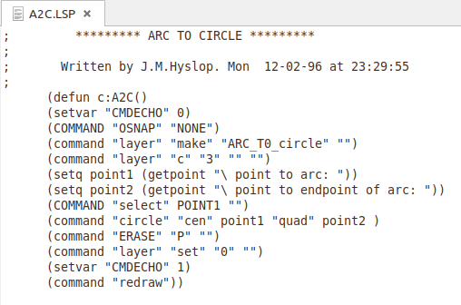

Hi All
Years ago I used to make very basic lisp files to do very very basic tasks, can anyone help me with this :|
Attached is the lisp routine :- and before anyone says yes there is probably a better way to make the lsp file
and also return osnaps to previous settings :lol:
All i want to do is select and Arc or even better window select arcs and turn them into circles.
There is a problem when sometimes exploding blocks circles become 1 arc with a start point 0
and end point 360, Qcad displays these arcs and one can assume they are circles, but when loading
the dxf into CNC software it displays as a Dot, likewise in AutoCad a dot / zero length arc e_surprised
Thanks for any help in advance
PS I didn't know how to insert it as code :cry: it kept saying Spam Detected , here is a screenshot
if you don't want to download the zip file..
A2C.LSP.zip
(427 Bytes) Downloaded 449 times

Hi John,
Already a while QCAD doesn't explode circles to 1 full Arc but in two 2 semi full Arcs.
A Polyline that is.
Recently, explosion of circles is made optional in App.Prefs.
Below you'll find a script for full Arcs to Circles:
Regards.
